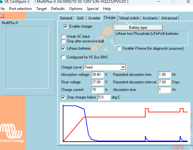

I have 2 small standard lifepoe+ battery with no internal temperature sensor, Also I have a Victron external temperature sensor. Why does it randomly charge my battery when it is -5C? I already destroyed 4 batteries last season. I am set as lithium battery in the cerbox GX configuation. Thank you!

For regulations issues not using ESS. It disconnect from the grid when there is enough sun and reconnect when the battery is depleted. That feature works awesome! not sure where to find this dvcc but I am attaching my config file. the only issue I could think of is that I selected in the assistant the Gel Victron because none of the battery selection in the profile allow to connect a none BMS battery…
Multiplus_II_24V2400_1_c0619ab213e8_inst_ttyS4_Interfaces_Mk2_Tunnel.rvsc (5.4 KB)

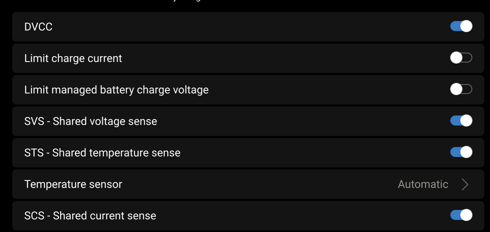

DVCC is found on the GX.
I see, the DVCC was not enable. So I did enable it and left it default. hopefully that’ will do the trick…
Under temperature sensor, it says automatic, just check that it is picking up the temperature sensor that is on the battery.
Thank you LX. It is working great today! no more battery destruction during winter….
