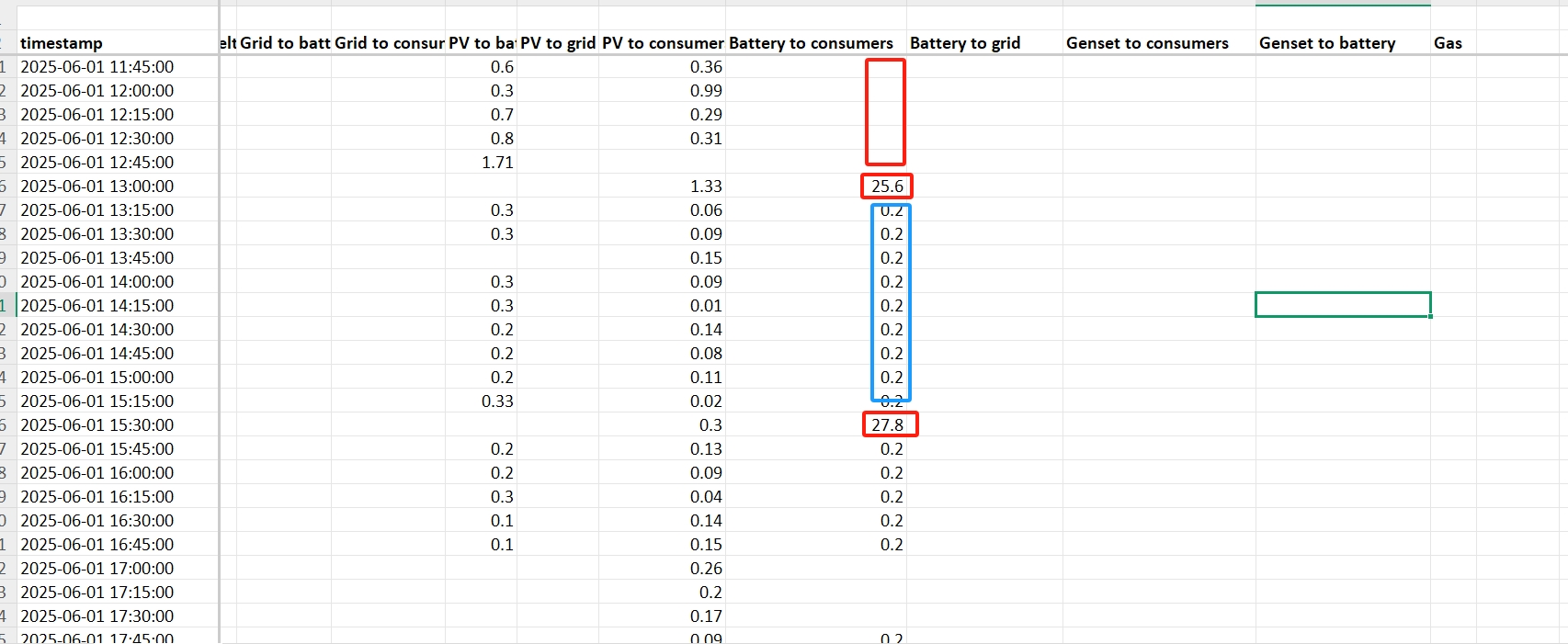

Customer feedback indicates a major issue with BMS data reporting on the VRM platform. As shown in the attached screenshot, the system at one online site (PG0257) reported abnormally high daily energy consumption, such as 486 kWh on June 10th. This implies a continuous 24-hour load of ~20 kW, which is clearly inaccurate — the actual site load is approximately 1 kW.
To investigate further, we downloaded the historical kWh data from the Advanced tab on the VRM platform into Excel for analysis. The data clearly shows that the error originates from the battery data provided by the BMS. For instance, as shown in the attachment, the “Battery to Consumer” value suddenly jumps from a typical 0.1–0.2 kWh to 33 kWh in just 15 minutes, which is impossible given that the site load never exceeds 1 kW.
We have also observed similar anomalies in the “Grid/Solar to Battery” values in some cases. These errors significantly impact all related energy metrics.
Accurate energy reporting is mission-critical for this project, as our customer must generate daily and monthly performance reports for submission to the end users.
For the first five sites, we were forced to manually correct the errors in Excel for every 15-minute interval, which is already extremely time-consuming for a single month’s worth of data.
Scaling this to 70 sites on a regular basis would be unsustainable.
Based on our observations, it appears the issue may originate from the BMS system, as Victron’s system relies on BMS data for energy reporting and consumption calculations.

It’s my understanding that in general, BMS current monitoring is notoriously bad. Also it’s unclear how you are aggregating BMS data from multiple batteries. Have you considered a Shunt? If you were aggregating, with so many batteries, that’s a lot of points of failure. A shunt means a single point of truth.

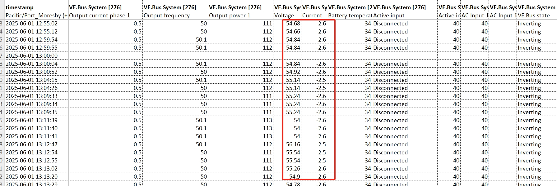

Jumping the battery voltage from 55 to 54 Volt and some minutes later back to 56 Volt within one minute is highly suspicious. What chemistry and what BMS do you use? How is the SOC calculated?

If you have only AC consumers, powered by the inverter, try to do the plotting/analysis based on the power or current reported by the victron inverter and not the battery’s BMS and see if it’s the same.
