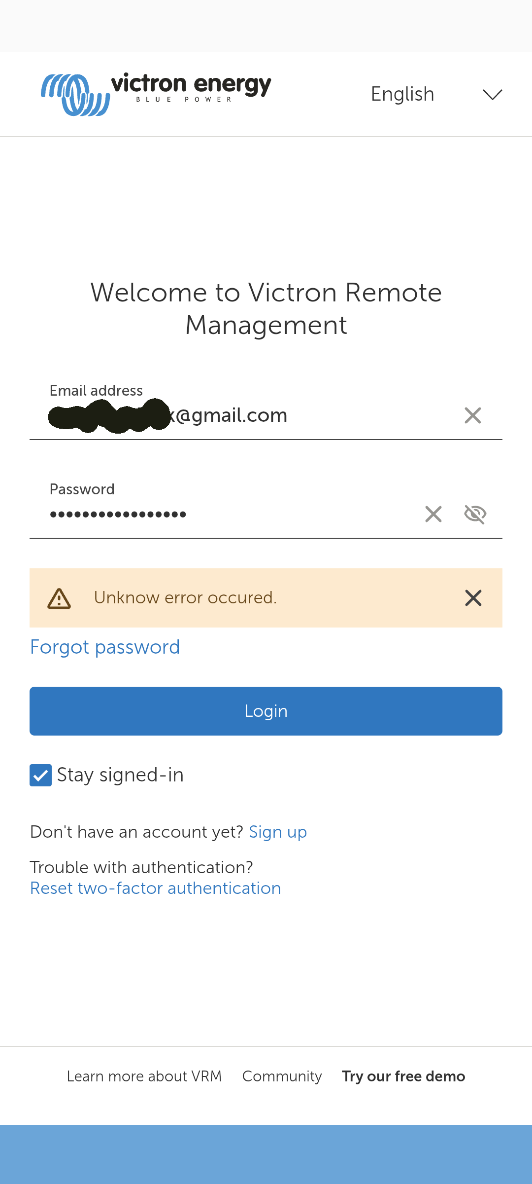

I have also just tried to login via my phone’s web browser using my mobile data and I get an “Unknow error occured” message in orange.

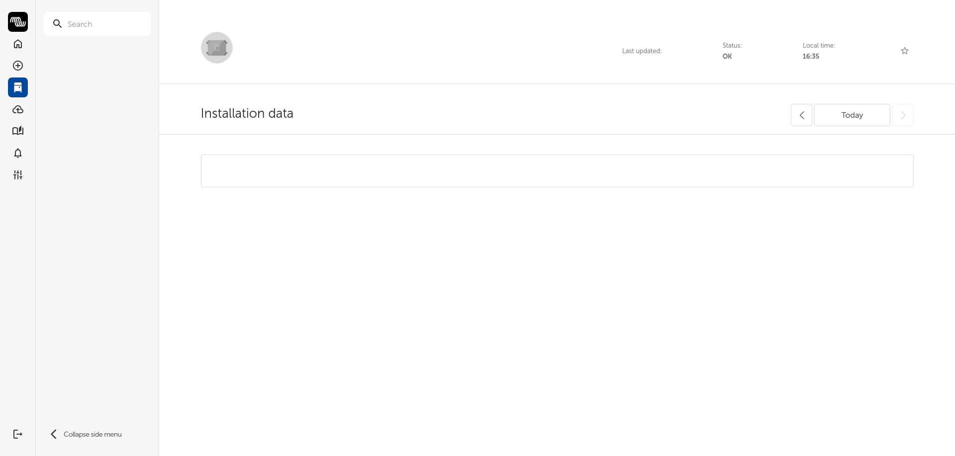

A few hours later and it is not functioning properly via pc browser as it shows in the “All installations” yet it wont load anything when I click on the entry for the only installation I have. It is currently working, showing real time data (after a long delay) through the Android VRM app. This is getting quite frustrating.

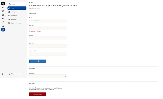

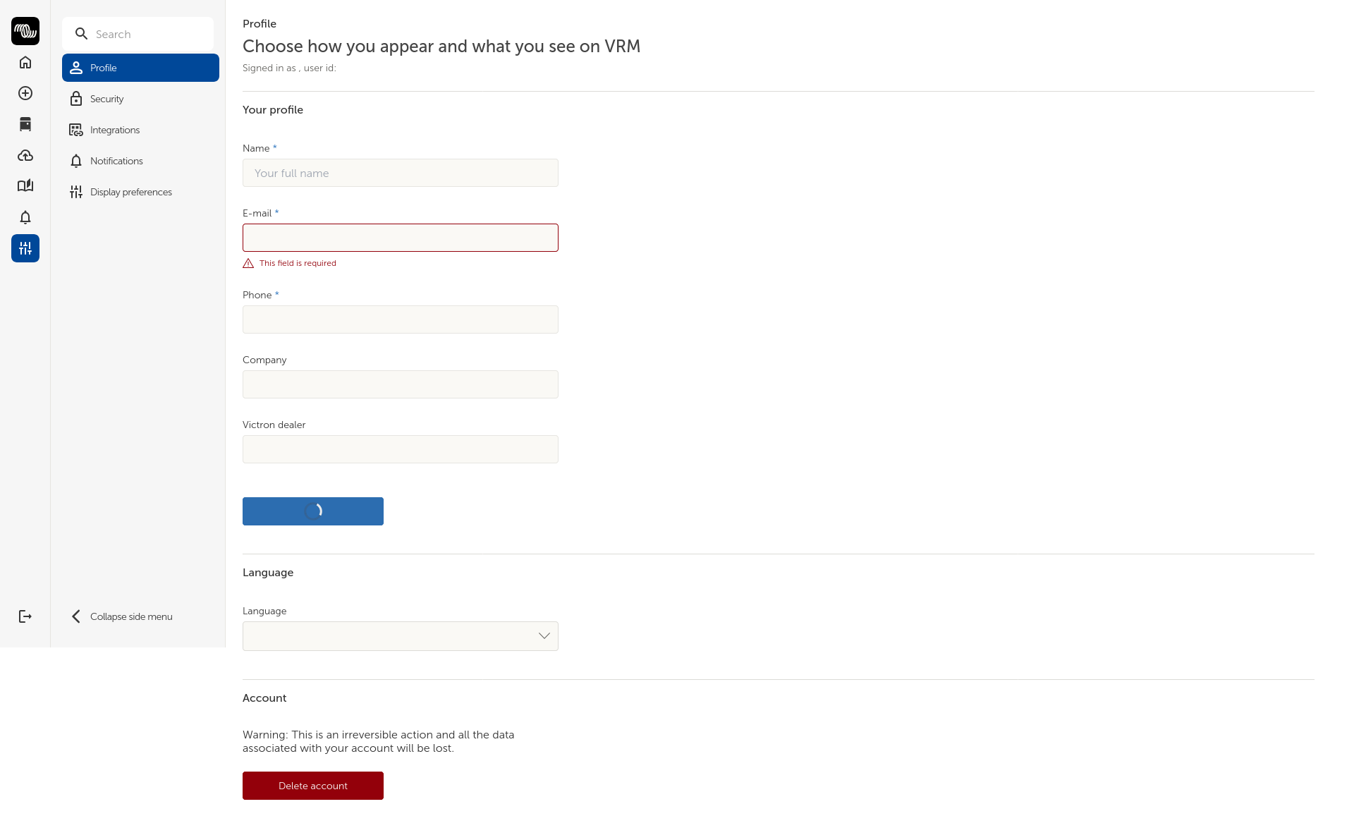

I just logged out of the VRM page on my PC.
I cannot login afterwards.
Inspecting that page I get the following:
MOD EDIT - PROVIDED DETAILS PASSED ON TO DEVS

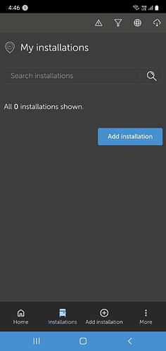

A little additional info for you. I am currently having the issue again on both devices.
I noticed the VRM app on my phone was not working again. I go to my computer and look at the already open browser tab that has the VRM displayed. The PC browser VRM takes a few seconds to update and display realtime data but is working. I check the phone app again and have nothing displaying so I hit the “home” button then the “installation overview” button and then “all installations” The “all installations” button does nothing and I am stuck on that screen.

Previously at times it has on the web browser VRM found my installation but then not displayed any data when it is selected.

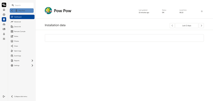

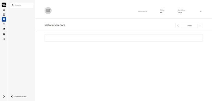

update it just found the installation on the web browser VRM after a good 10 minutes, I have clicked it but I am now seeing an empty “installation data” page. I will leave this tab open for a bit and see if it comes up. screenshot of this:
update 2 The installation data page updated to where it now shows the name and icon for the installation but no data is displayed. It has been like this for over 10 minutes now. When it displayed the name and icon it also started showing a “last updated” time. It currently shows it was last updated 15 minutes ago but there is still no data displayed. screenshot of this:

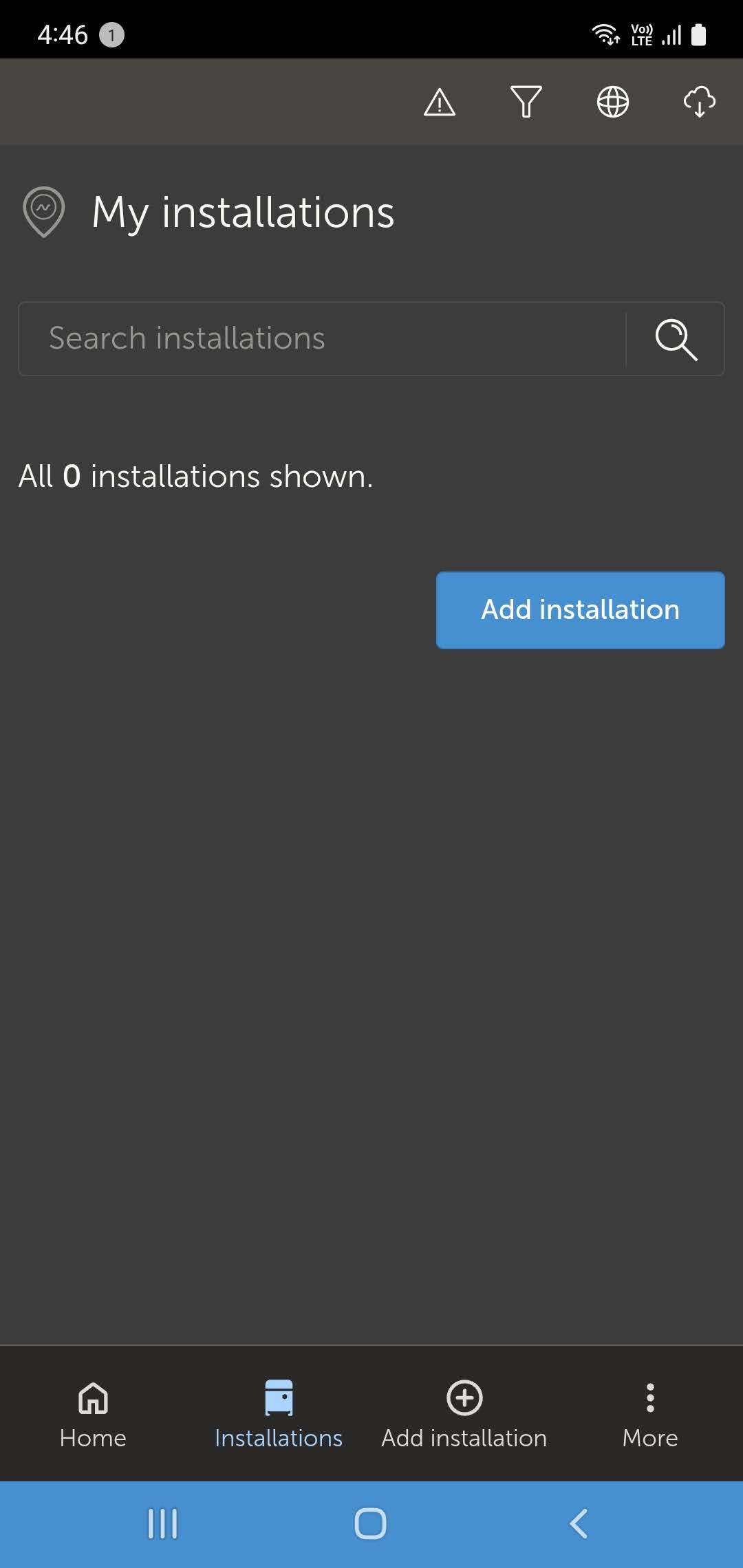

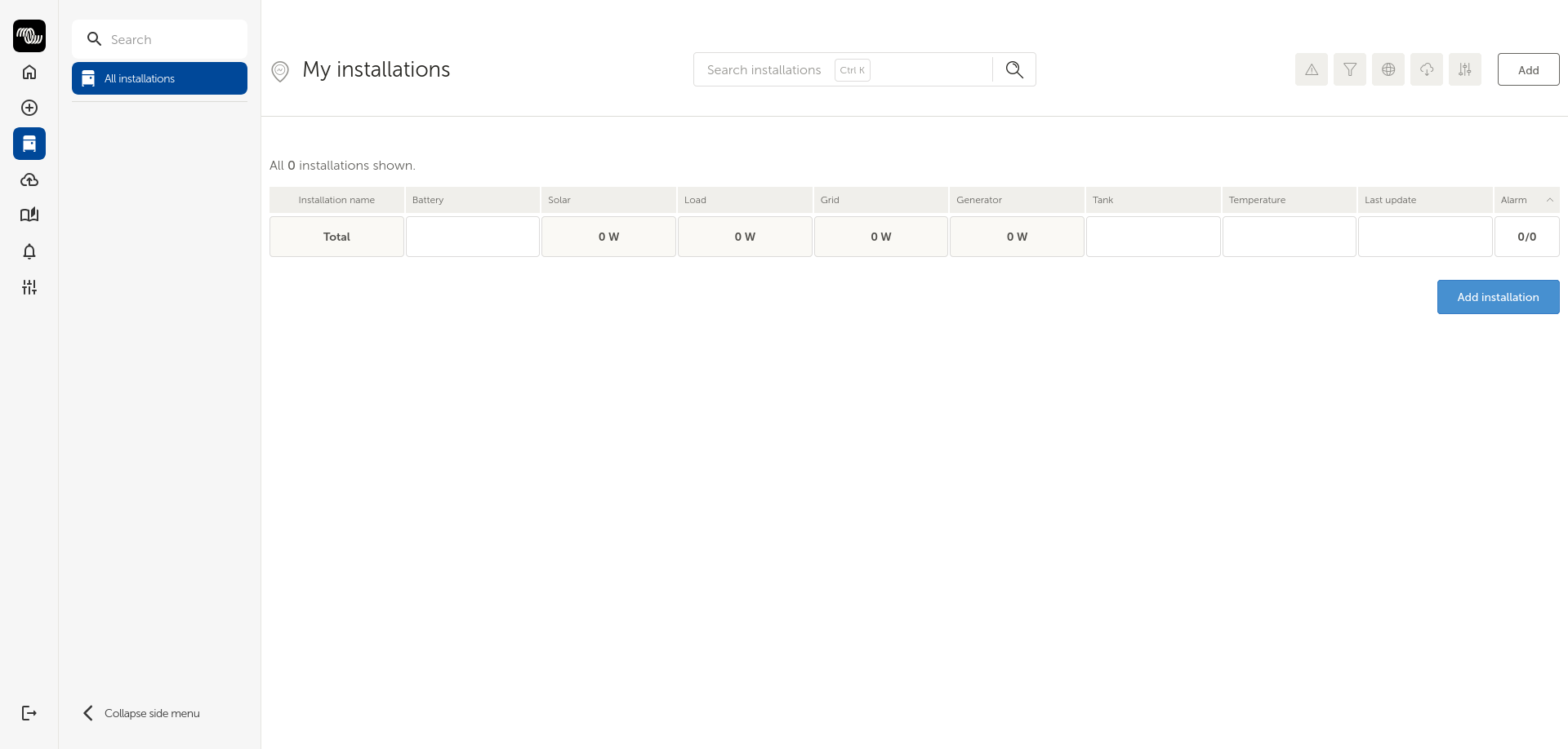

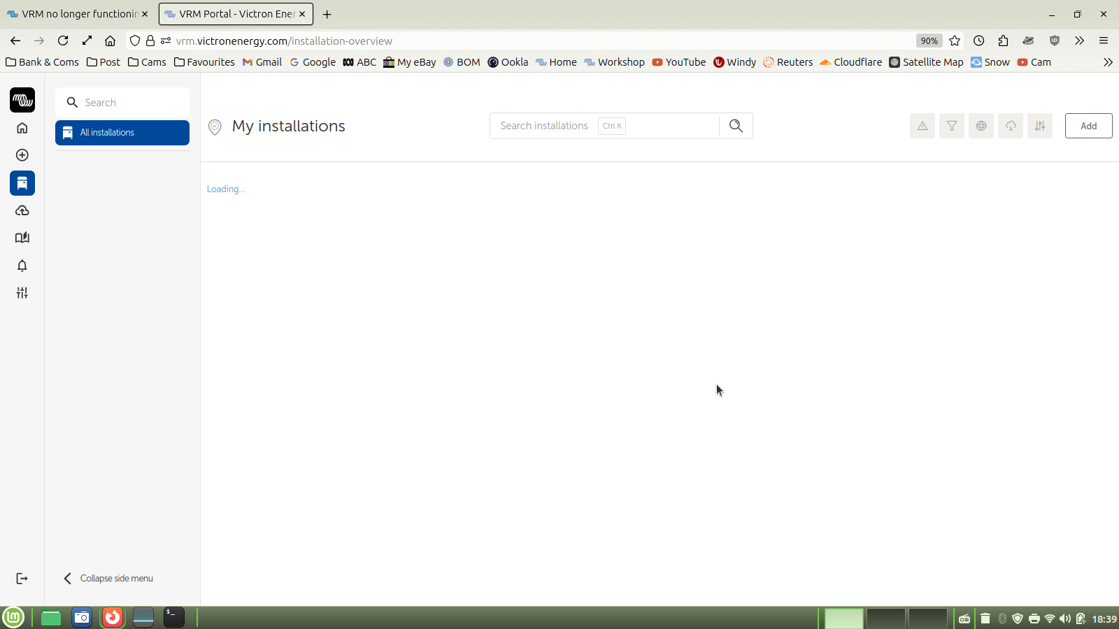

I decided to exit the installation data page that still hadn’t shown any data and go back to the “all installations” page. It sat on loading… for a few minutes (about 4 mins) before coming up " All 0 installations shown". screenshot of this:

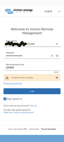

Tried to log in multiple times, but, if the two factor code arrives, it fails at this point. tried again five times a while ago, but just get Unknown error occured.
Tried again multiple times, finally received a sms 2FA after around 20 seconds, input-ed it into the sms field, then waited another 20 seconds……but it failed with error message again.
