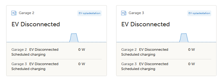

I have two EVCS installed. The VRM dashboard seems to mix the data from EVCS 1 and EVCS 2.
The graphs are identical, but only EVCS 1 was used and if you expand the details, you will also get a mix of both under each EVCS.

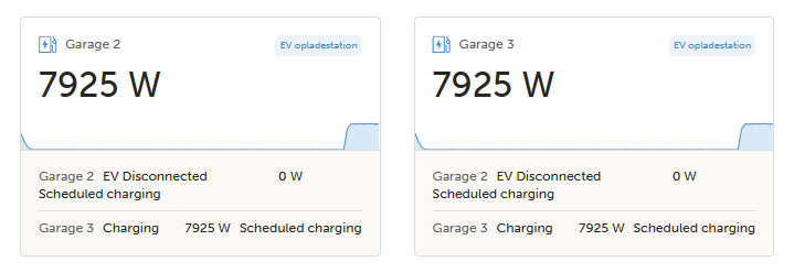

Bumping this. Even when charging, both EVCS display the same.
