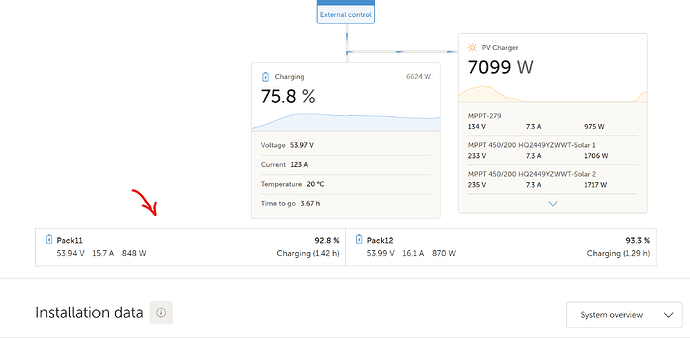

Hi guys,
i have a setup here with 6 Serial Battery instances, which are summarized for Venus OS by the aggregator. We just added yesterday 2 batteries (it were 4 initially), and modified the aggregator to use all 6 of them now. Everything works, but now in addition the Dashboard shows me the Data of the single batteries in a dedicated row below the visualization - is that like a test of a new feature? I’d like to see the details there of the other 4 batteries as well - but how can i enable that?

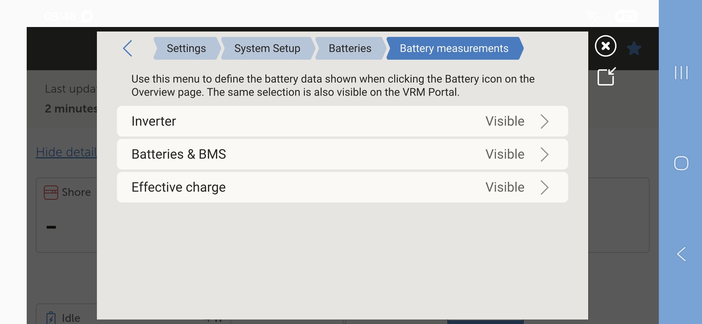

You choose which ones are visible in settings/system setup/ batteries/ battery measurements
Ah didn’t know that - thanks! It’s limited to 5 entries it seems…:-/
