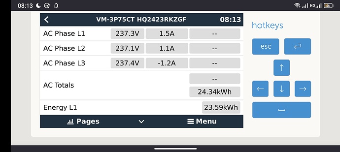

In the cerbo gx console I saw voltage and current values but no POWER values in the list.
The Victron Connect App shows new values, Phase Sequence and others.
Could it be, the data format (VE.Can) was changed?
I inspected the gx device. Here was also an firmware upgrade (to V3.66) available. Made this.
Power values are now visible. The ESS runs.

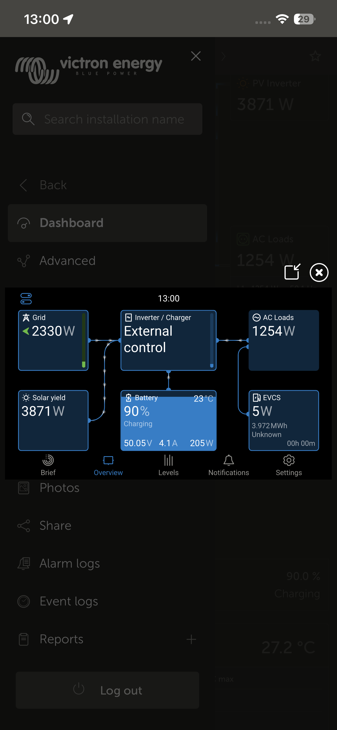

@mpvader I’m not sure if this is the same issue but it appears to show wattage in the remote portal but not in VRM I changed mine to EV so I’m not sure if it’s the same as I was told that 1.10 wasn’t implemented into the VRM so would give wattage. Cerbo GX running 3.65 See screen shots
Hi Dirk. I’m not even surprised. Still. A warning would have stopped me from updating to v1.10 Anyway. Sooner or later I too will use v3.66 but for now I’m stuck.
