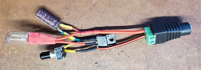

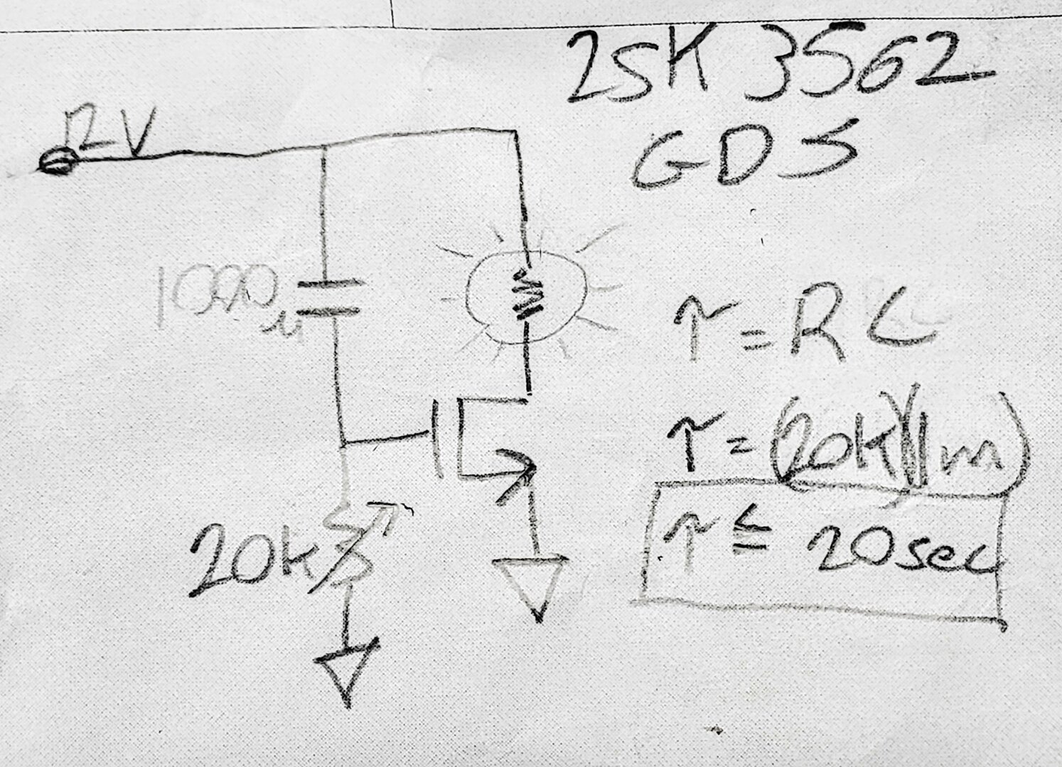

Here’s the details of the circuit I made in case anyone else finds it useful, but again a simple firmware fix would make this unnecessary.
I designed a little circuit to turn on a 12V 5W automotive lightbulb for about 10 seconds and then switch off. I’m running this off a 120V to 12V AC-DC 500mA “wall wart” power supply that I had laying around. The circuit operates at 12V and is limited to 500mA through the power supply. I was able to scrap the capacitor and NMOS transistor from an old switching power supply that I didn’t need. It successfully tricks the Victron into staying on until the fridge compressor has time to engage. Now, the Victron only wakes up every ten minutes and runs the compressor if needed to get to the programmed temperature and then goes back to sleep, exactly as I wanted.

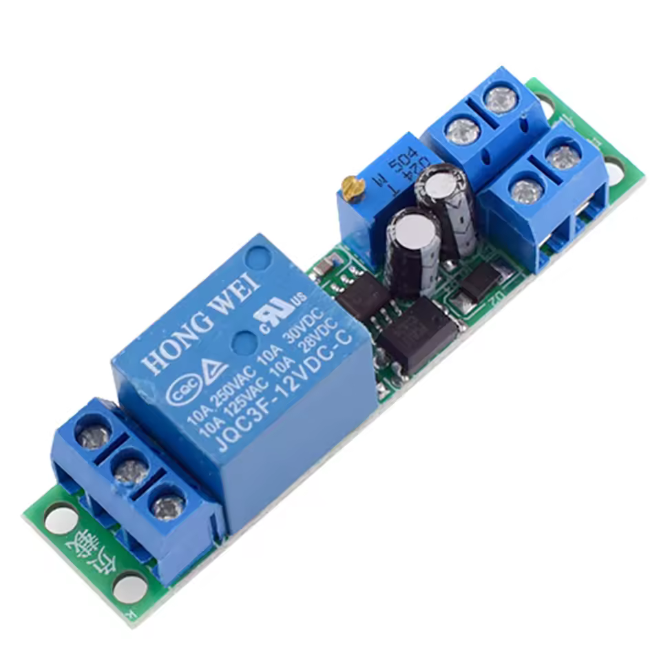

If you dont want to design your own circuit to do this, they make simple modules to turn on a relay at power up and turn it off after a short time. You could use this and wire a 12V power supply and a 5W light bulb to the relay outputs. Search google for “DC 12v signal timer relay adjustable delay” to find many options on amazon or aliexpress.
