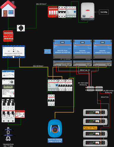

Hello everyone,
I’m currently planning my system and have a question: am I allowed to mix the Multi RS Solar 48/6000/100-450/100 and the Multi RS 48/6000/100-50 230V in a three-phase system? (I don’t need that many PV strings.)
The unit certificate doesn’t explicitly state that this combination is possible either. I just don’t want Bayernwerk to object when I register it :face_with_crossed_out_eyes:
Thanks
This exact scenario was one of the reasons for developing the Multi RS without Solar.
By the way, why is the Multi RS Solar cheaper than the Inverter RS ​​Solar?
Thanks, is this combination also legally permitted in Germany?
The Multi RS models without solar currently don’t have the corresponding certification yet, but I suppose it’s already in progress.
IDK
Maybe higher demand → higher production → cheaper price?
Oh dear, I guess I’ll have to go with the RS Solar after all—I want to get started ˆˆ
As these are essentially the same devices, certification should go relatively smoothly.
You can start already, in theory; you just can’t put it into operation yet.
