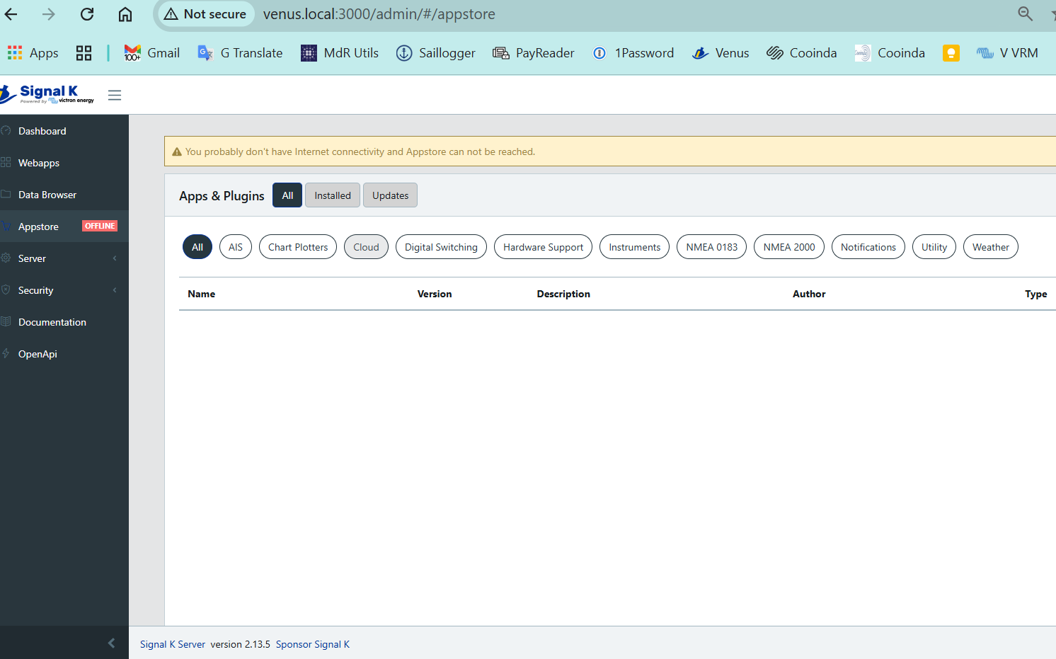

I installed V3.60 from V3.55 and noticed I lost NFL tracking via SignalK. Checking via Venus local I got the banner message you probably don’t have internet connectivity and the appstore showed offline in red. I reverted to V3.55 and all was working again including the NFL plugin. I then reloaded V3.60 and have the same problem again. Any thoughts to force connectivity. I haven’t had to make any internet connection settings in the past. SignalK server Version 2.13.5.

I have this same issue - was working then just stopped for appstore says offline, and NFL stopped updating.
However AISforwarder and SK to Windy are working fine. Tried previous fw (3.65) same issue.
Log error for NFL
Nov 02 21:57:30 2025-11-02T21:57:30.408Z signalk-to-noforeignland Could not send track to API due to error: FetchError: request to https://www.noforeignland.com/home/api/v1/boat/tracking/track failed, reason: at ClientRequest. (/data/conf/signalk/node_modules/node-fetch/lib/index.js:1501:11) at ClientRequest.emit (node:events:518:28) at emitErrorEvent (node:_http_client:101:11) at TLSSocket.socketErrorListener (node:_http_client:504:5) at TLSSocket.emit (node:events:518:28) at emitErrorNT (node:internal/streams/destroy:169:8) at emitErrorCloseNT (node:internal/streams/destroy:128:3) at process.processTicksAndRejections (node:internal/process/task_queues:82:21) { type: ‘system’, errno: ‘ETIMEDOUT’, code: ‘ETIMEDOUT’ }

I never got a solution to get 3.60 to operate with SK and NFL. However either by luck or by design it appears Victron have repaired things as all works fine with 3.66 now for me. Sorry I have no more than that.

I updated to latest beta firmware and that fixed store issue for me.
NFL - worked with developer to find a fix
