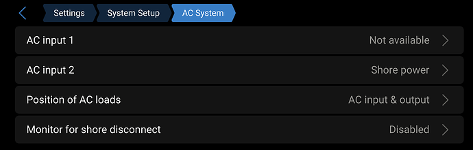

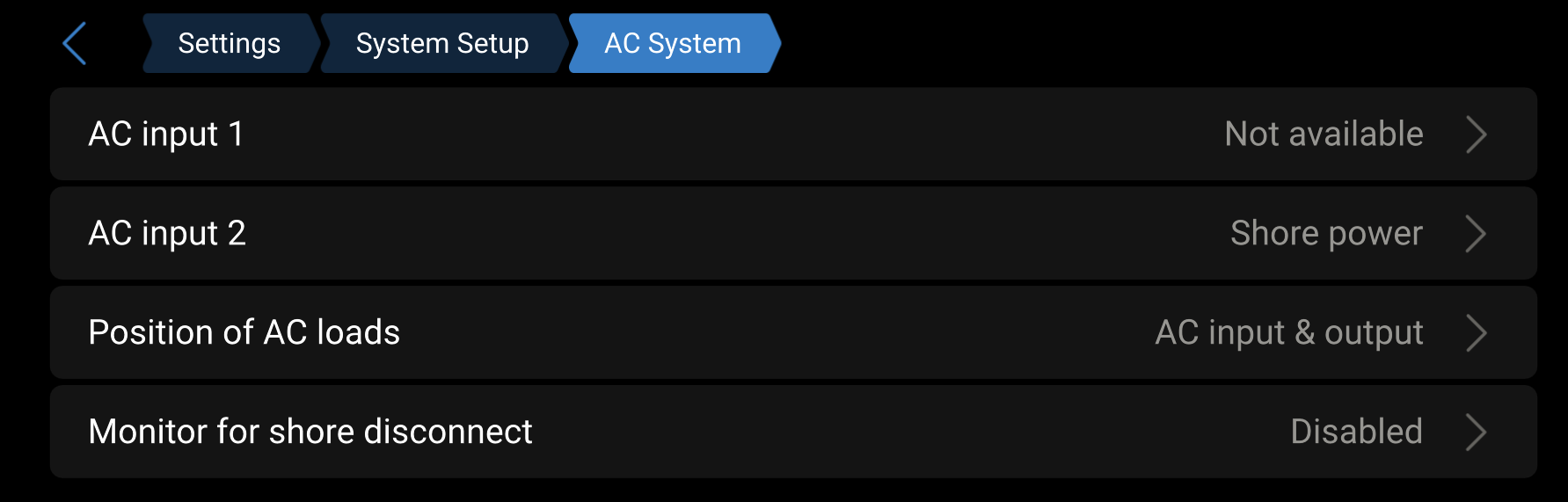

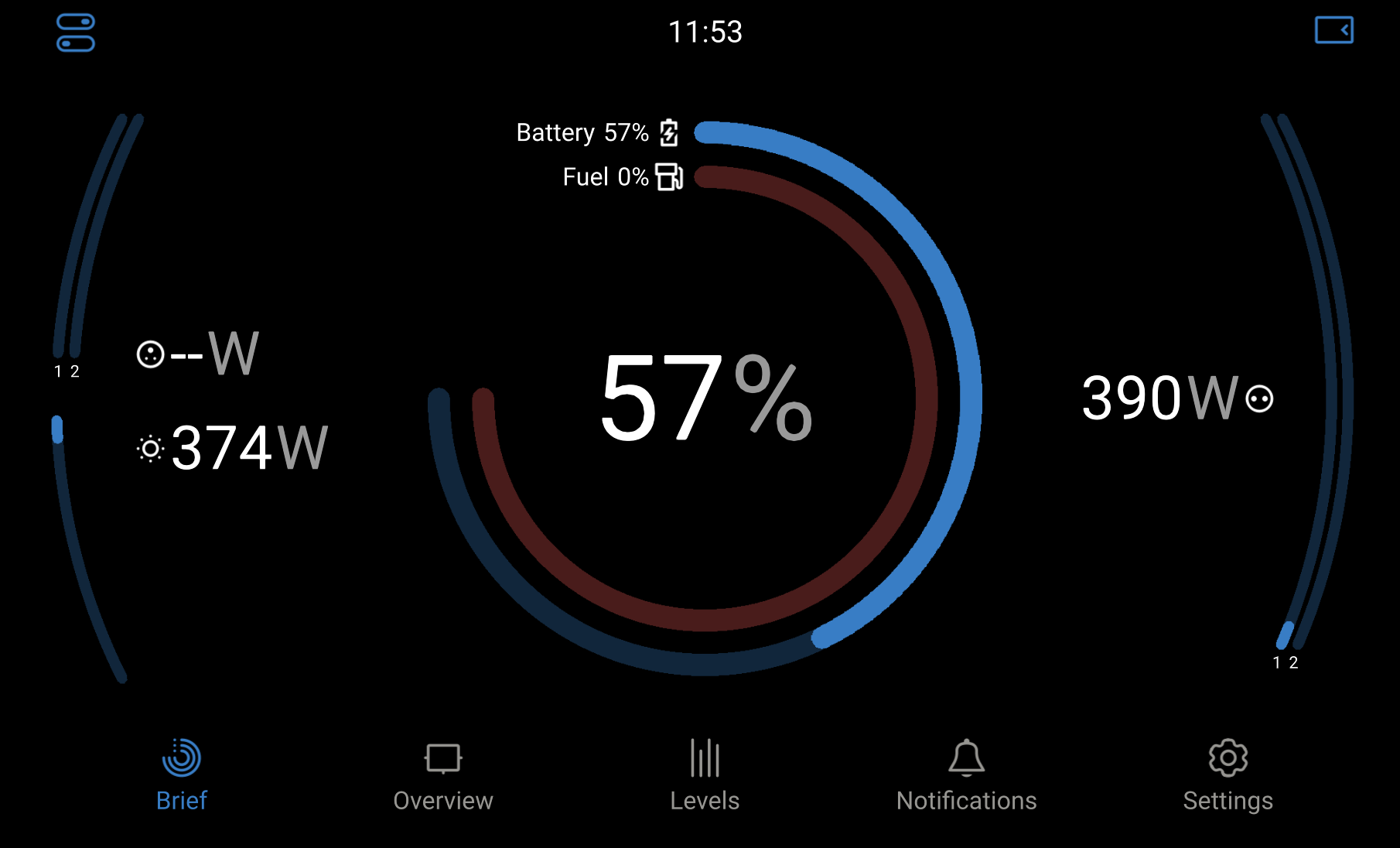

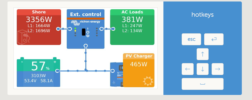

I have a 2x Quattro 5k/120 in split phase mode with Cerbo (and SCC, Lynx, etc). Ever since upgrading the Cerbo and switching to the V2 UI, shore input is always blank even when it’s drawing power. When I switch back to V1, it correctly shows the power. I’ve rifled through the settings quite a bit and I can’t seem to fix/explain it. I just upgraded Cerbo to 3.66 and it’s still a problem with the V2 UI. Thoughts?
Do you really use the AC IN 2, not AC IN 1?
Yes. And V1 works with this setting, too.

VRM shows correct values … just not Venus V2.
