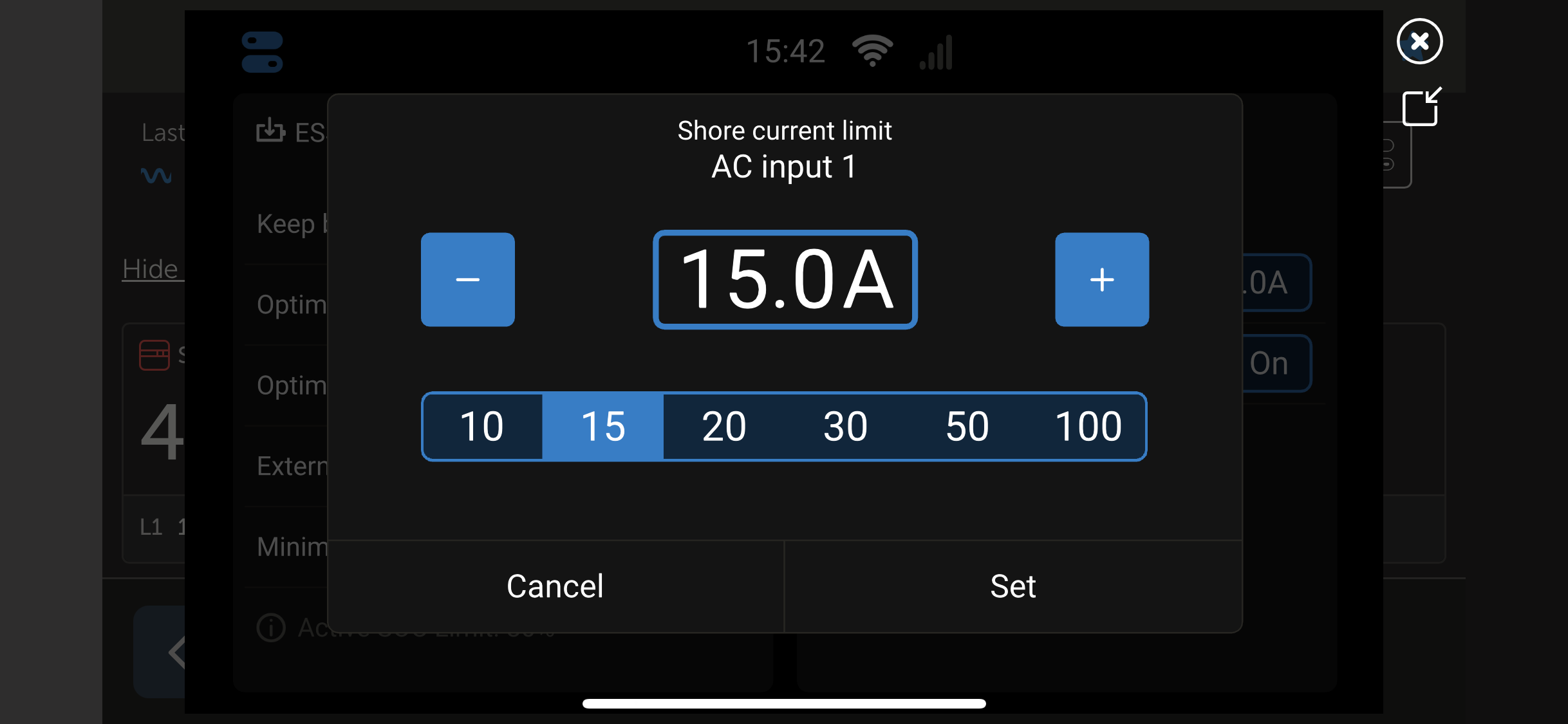

Console presets, screen or remote, no longer work with “set” button. Input current setting.
Using the +/- buttons,then set, works.
3.70~28
Pretty sure that’s a know issue, I bumped into it a few days ago.

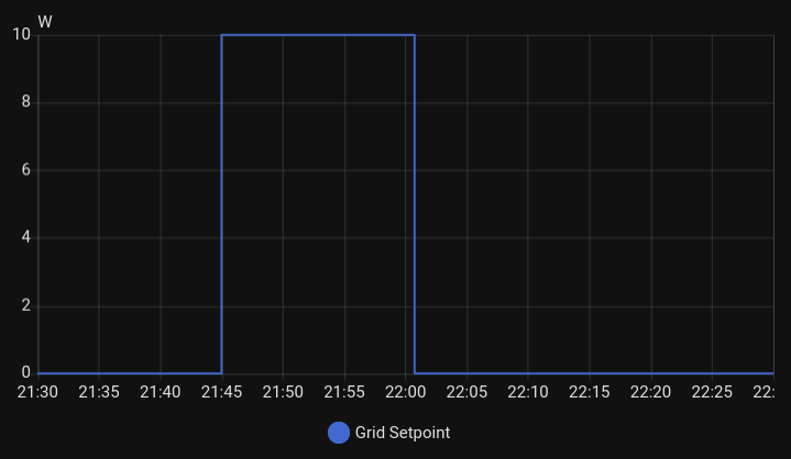

Well - then may I ask why my setpoint is being reset to 0W on every full hour (aka when a new DESS window starts)?
I have nothing in place that will touch the setpoint, like NodeRed or some Homeassistant script.
This is a plot of the setpoint being reported via MQTT (venus/N/caffebabe42/settings/0/Settings/CGwacs/AcPowerSetPoint):
And again: As soon as I disable DESS, it will not be reset to 0W anymore.
In dynamicess.py there is a bunch of lines setting HUB4_SERVICE, '/Overrides/Setpoint to 0:
Wouldnt’ it make more sense to set it to None instead? Because I assume an “override” of 0 is exactly this: overriding any user grid set point with 0.
Edit: when DESS is getting deactivated, it will indeed set the override to None
DESS is just setting a temporary override (/hub4/Overrides/Setpoint), it doesn’t modify your settings in /settings/0/Settings/CGwacs/AcPowerSetPoint
So, if you are tracking the settings-path: Whatever is resetting that path to 0, it’s not DESS…
I will review that else-line in discharge(), but it should not be used at all anyway. It dates back to the 3.5x delegate, and has been left there as a double-safety-doesn’t-hurt-check to prevent feedin from happening when not allowed. The new delegate shouldn’t even call the discharge() method, when feedin is not allowed, as the scheduler won’t (aka shouldn’t) generate a strategy advising “grid coping”, when feedin is restricted. (But that’s suspect to review)

Ok, turned out to be my fault - had a script that I totally forgot about which was supposed to maximize consumption from grid and battery charging whenever prices become negative but setting charge / discharge power via MQTT stopped to work with some Venus OS update so I started to mess with grid set point as a temporary work around and totally forgot about it. Don’t remember prices ever going negative this year, but one effect of that script was that on every price change (which happens every full hour) it was resetting grid setpoint to 0W :see_no_evil_monkey:
