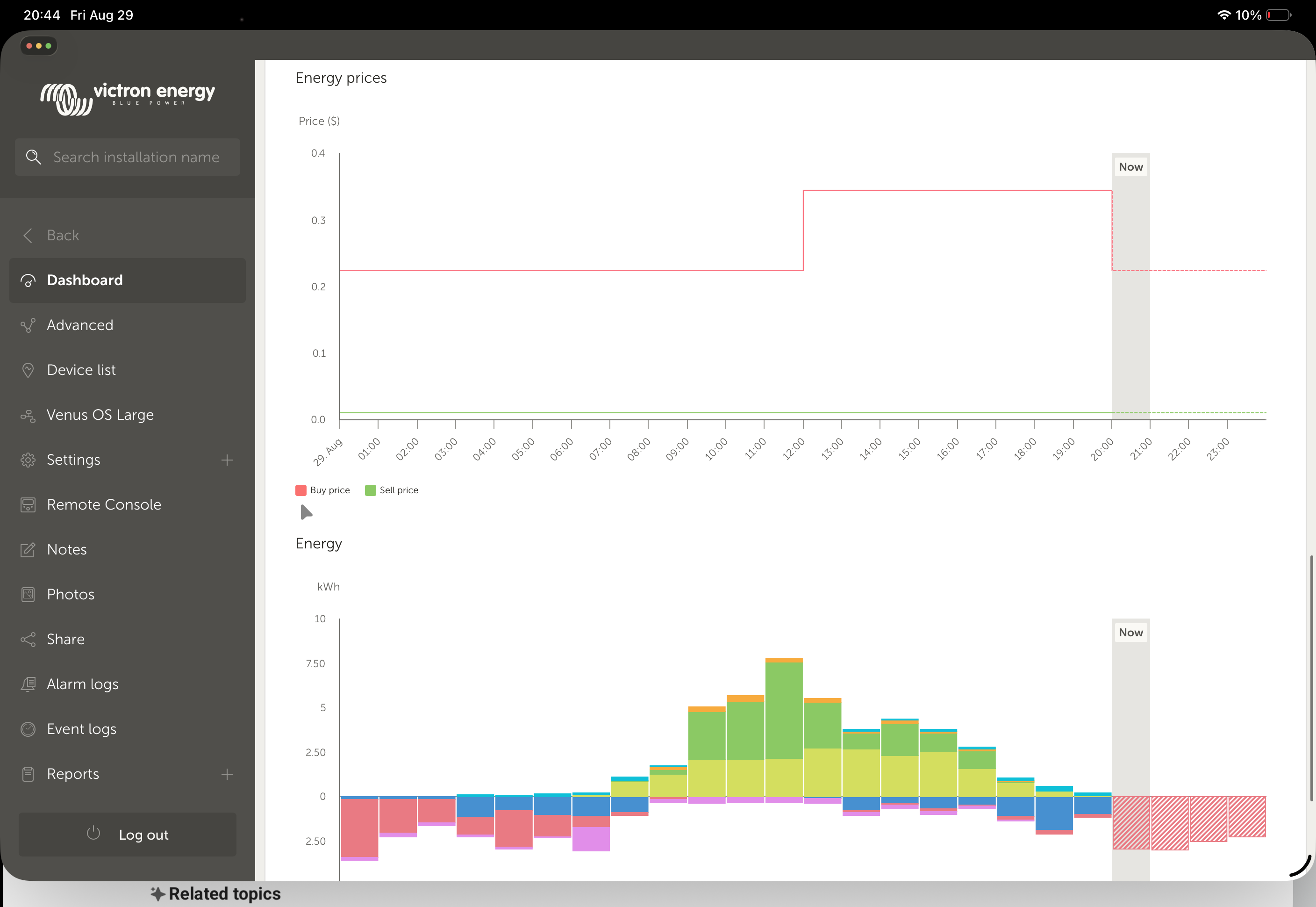

I’m uncertain as to why my system is currently self-consuming at the moment. The DESS plan indicates consumption from grid, the target SOC is 89% (vs. actual of 85%), and we’re on Reactive Strategy “20” (not sure which this is). 3.70~28
EDIT: I ‘downgraded’ to 3.65~3 within the scheduled hour, and the system started properly consuming from grid (under Reactive Strategy 15). Maybe this is a bug with the new strategy introduced in 3.70 @dognose ?
