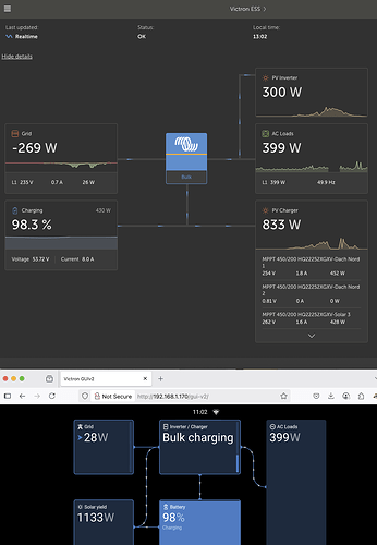

This screenshot shows the live VRM “display” and (below) the guiv1 display of a “remote console” on local LAN.
Despite the fact that the SMA inverter is not shown on AC/IN this is a correct representation.
Current from the MPPT ( PV Charger ) is completely used to charge the battery.
Current from the SMA inverter ( PV Inverter ) is completely fed to the grid on L1.
This is how it looks on the guiv2 display of the remot console on local LAN:
Solar Yield is correct ( sum of PV Charger and PV INverter ).
Connection Point of PV Inverter is correct ( line from Solar Yield box to AC/IN line from grid to Inverter/Charger ( MP II ) on grid side.
But the grid feed in from PV Inverter ( SMA ) is not shown.
It is shown on the VRM display.
Both are “live” pictures.
Is it a bug or a “feature”?
