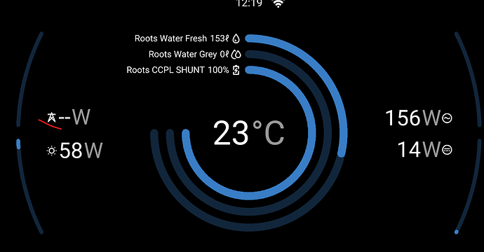

from few beta version now, the DC load is not shown in my VRM compared to my Ekrano screen settings…
I do not change (I suppose) any settings from a while… Refreshed the cache … nothing to do !!
A bug or some error in the settings

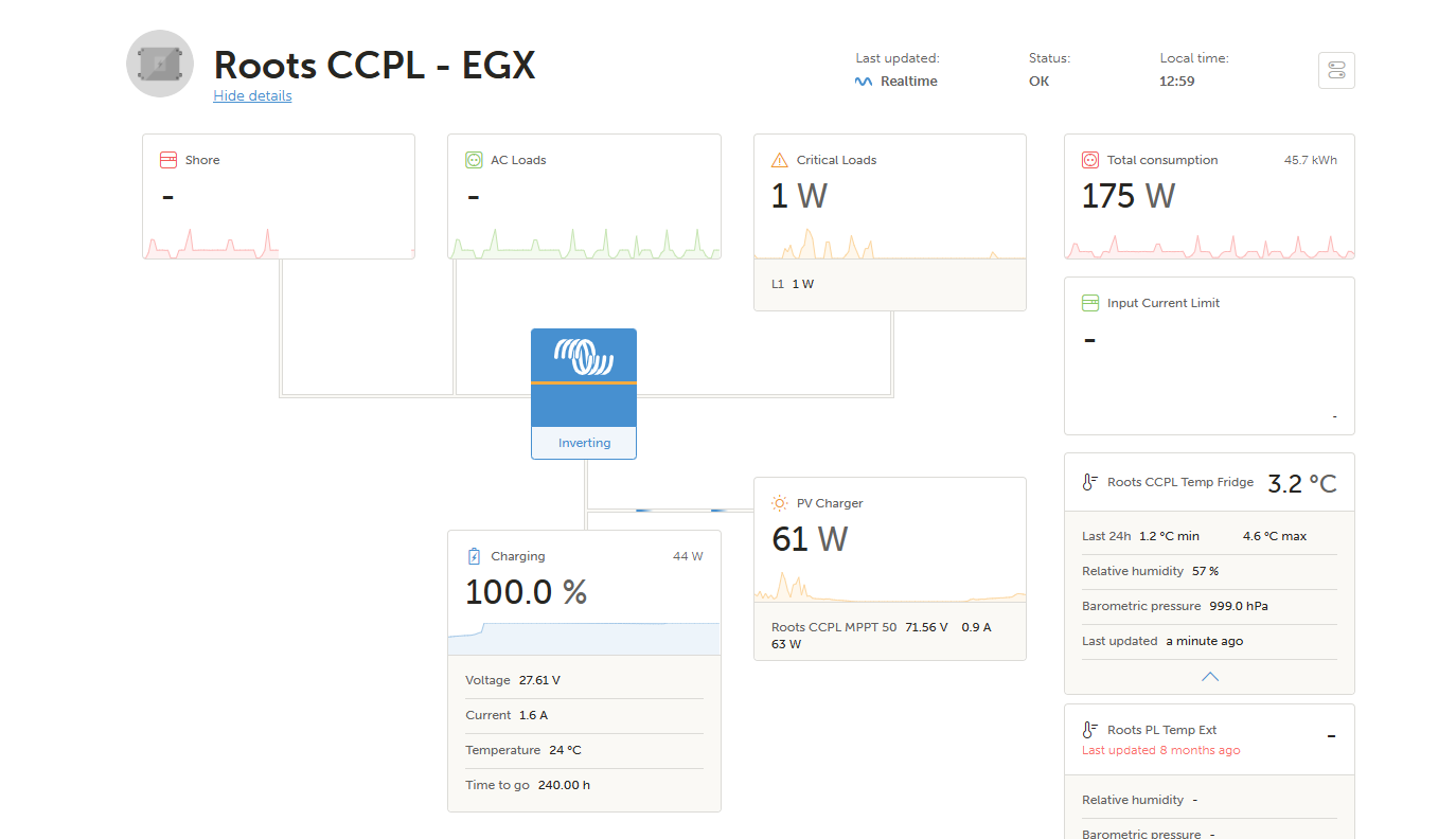

Hi,
After 3.60 update, the Ekrano is still presenting this trouble…
Unless the DC load option is activated on the device and remote screen :
unless refresh / CTRL +F5 .. log off and on again … it do not come up in the VRM interface !
Any tips ?
Xabi
Xabi
3

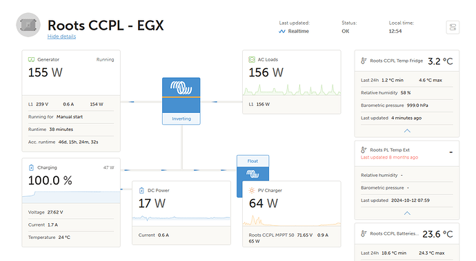

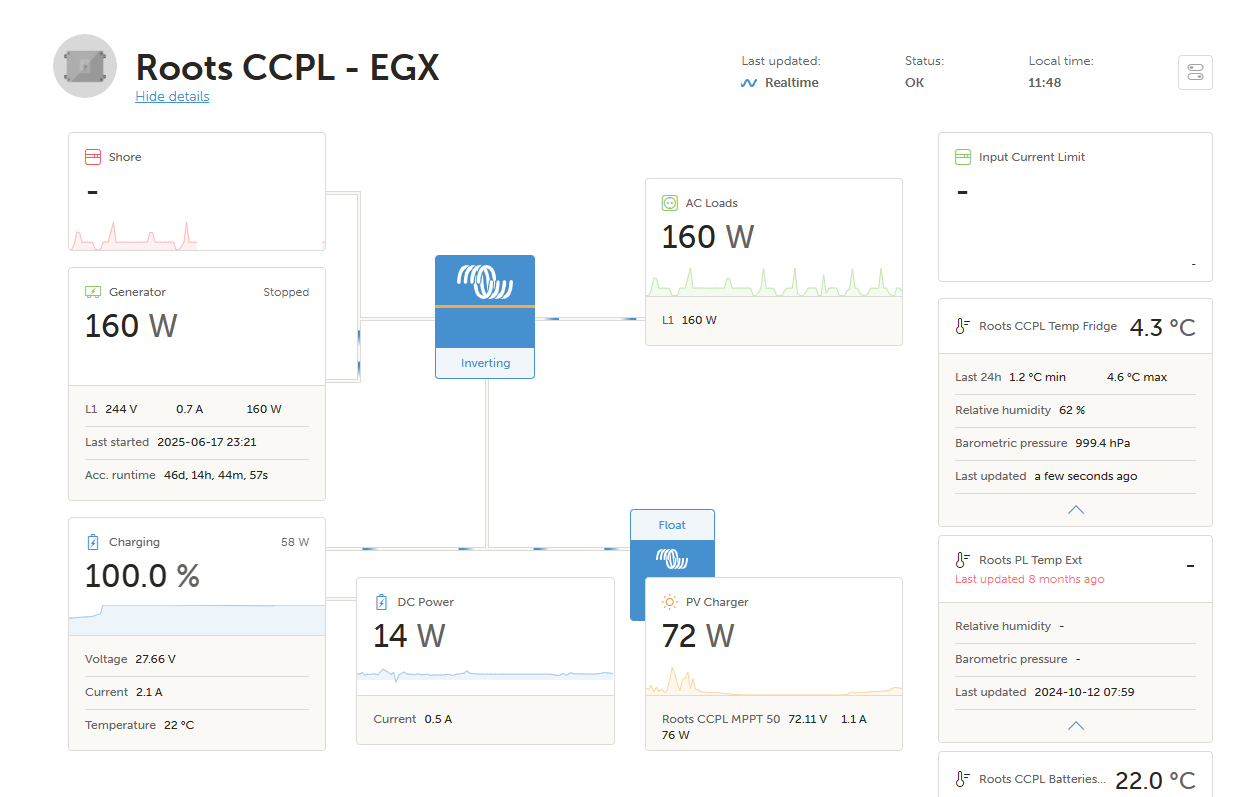

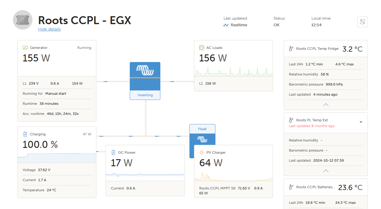

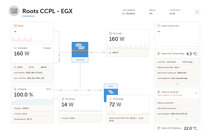

Hello,
some developpment with m trouble !

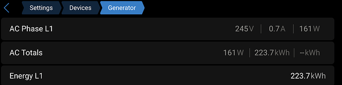

I use energy meter in AC imput and is set to Grid (shore)…

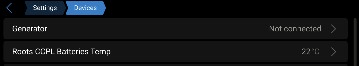

If I switch it to generator … the DC load figure come back to VRM screen.
But it is shown as not connected !
the Brief view is still incomplete …
Grid meter do not show anything…
Unless there is power thru the energy meter…
(I have an other installation with energy meter but I can see the value in brief view… )
Something strange…
And VRM after some time …
I’m a bit confuse with this setup… I do not find the error I made …
Then if I switch back the energy meter to grid… the DC load disappear from VRM..
