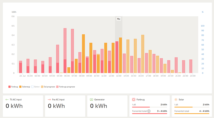

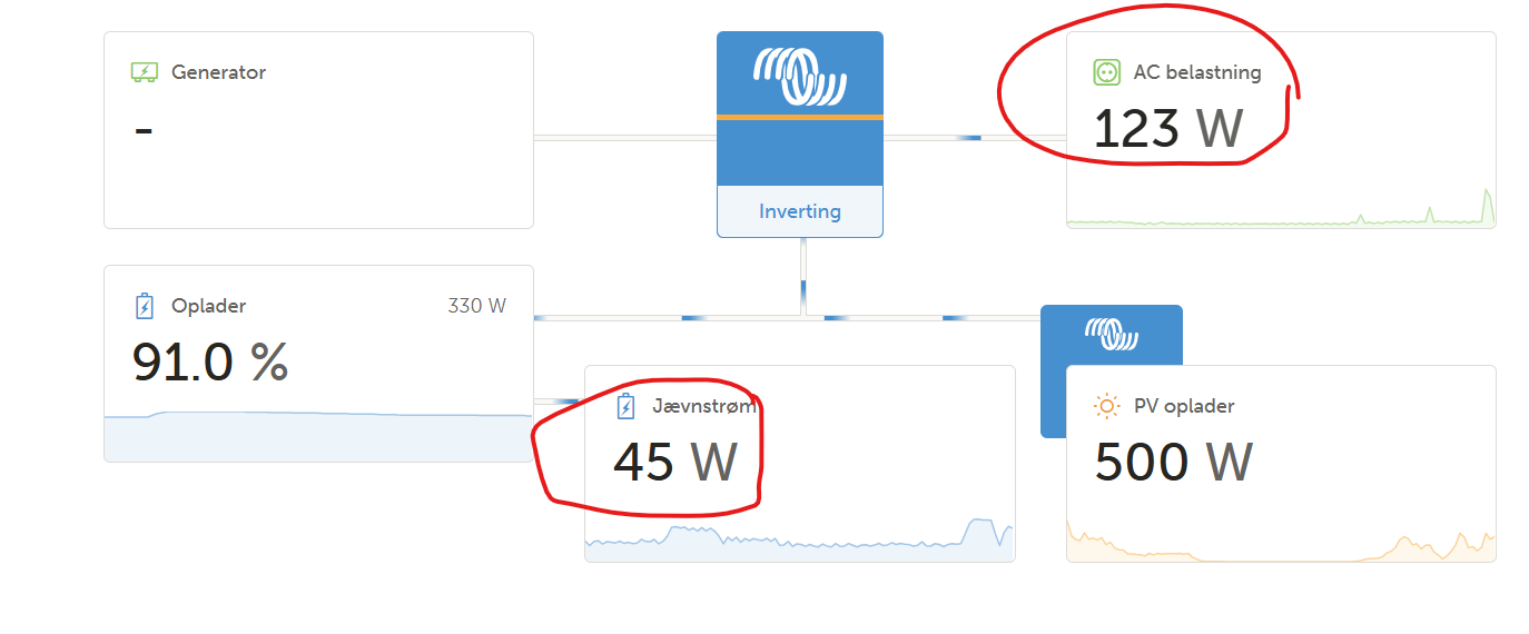

My consumption consists of both AC and DC loads, as shown in image 1.

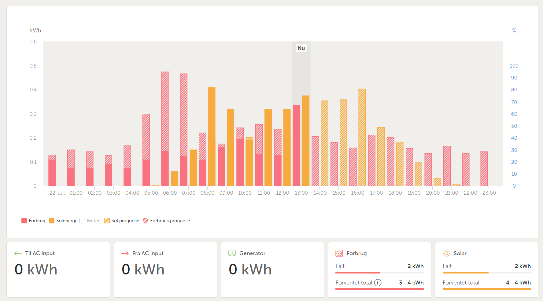

However, in the graph (image 2), my DC consumption is not included in the actual consumption (red bar), only in the forecast (hatched red bar).
Is this a recent update to VRM? ![]()
From the VRM documentation:
The calculated value for ‘DC Power’ is not used in any way by the GX, beyond just being displayed ‘on screen’. In particular it is not logged on the VRM portal and it is not included in system calculation and it does not appear as part of the recorded Solar Yield.

Nick isn’t guessing but stating a fact from here:
In an otherwise well-thought-out (if almost complete) universe, it’s surprising that Victron doesn’t include DC consumption in the total usage.

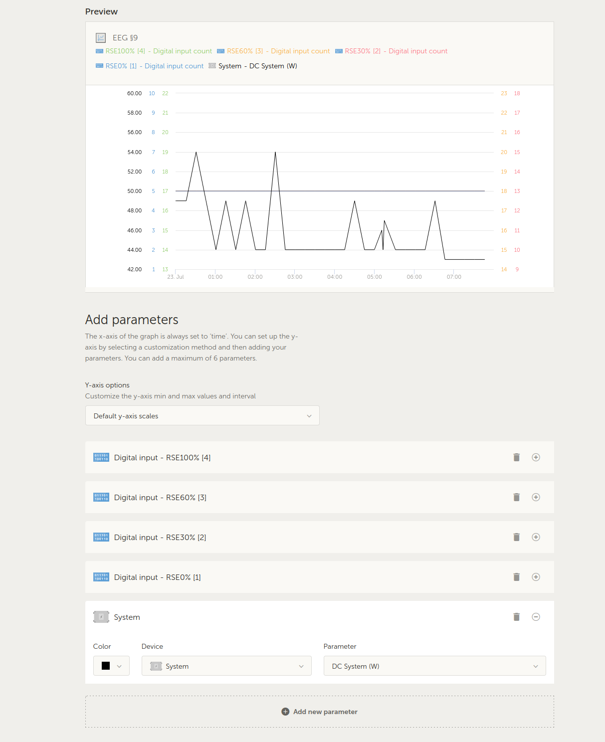

You can chart custom widgets in advanced. Using a shunt in the DC load role will provide visibility, just not on the dash.
VRM is a free Victron service. DC loads are available at Venus dbus and you might setup own VRM custom widget therefore:
