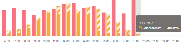

DESS needs to have a mechanism to cope with inaccurate solar forecasting (and unexpected consumption)
e.g.
