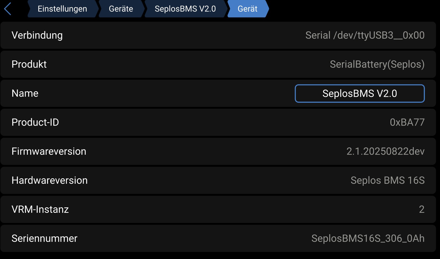

Yes ,i use serial battery (newest Version)
and serveral other drivers !

But i’ve installed the new version 2.1x which is completly supported with VenusOS 3.7x !
see : How to install, update, disable, enable and uninstall | dbus-serialbattery
and click on 2.1x night botton
