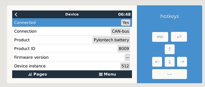

First, I can never see the individual battery packs for the Pylontech batteries; I only see my 20 modules as a whole.
So, I never get a display or information for individual Pylontech battery packs.
Somehow, based on the old forum, I seem to remember that the option to list information about individual Pylontech battery packs was only implemented with a certain newer firmware version.
From time to time, I get the following warning:
Which can then be acknowledged without any further action, and the problem is simply resolved. But I can never figure out what it means or which battery it refers to. The Pylontech itself never displays a warning or error. There are no problems in the Pylontech BatteryView log either.
With newer firmware, I suspect I could get more, different, and additional information to help narrow down and solve the problem.

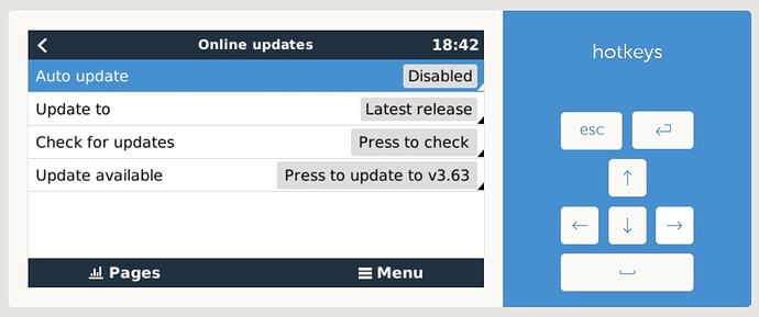

Secondly, I would like to expand my system on the solar generator side with four Victron SmartSolar MPPT 100/20. I want to add more solar modules, but I would like to connect them directly to the DC supply rather than to a grid-tied inverter.
And finally, I would like to use the “Android device as a dedicated display for GX” feature, which requires firmware 3.6.
I’m grateful for any suggestions and help!
Best regards - Ewald
Yes then i would update too!
Im on v3.00 and i have a bit more info on my pylontechs, however not individually only highhest lowest temp/voltage, but could be in v3.63 there is more info
Just for info:
Right now there is a slight isseu with dvcc voltage limit setting in v3.63 gui 2, but is already solved in next release, you can set it right in remote console or gui v1
The android gx display feature is nice!
Battery capabilities depend on the battery firmware. You may want to contact Pylon support and see if your packs and hub are up to date.
Looks more like a battery problem, not Victron/Venus OS.
The Venus OS can only show the information it gets from the connected devices.
Ask Pylontech about updates for your batteries and the HUB.
2.6x to 3.6x is a huge step so you definitely have to check all setting after the update and you also should update the FW of the MultiPlus.

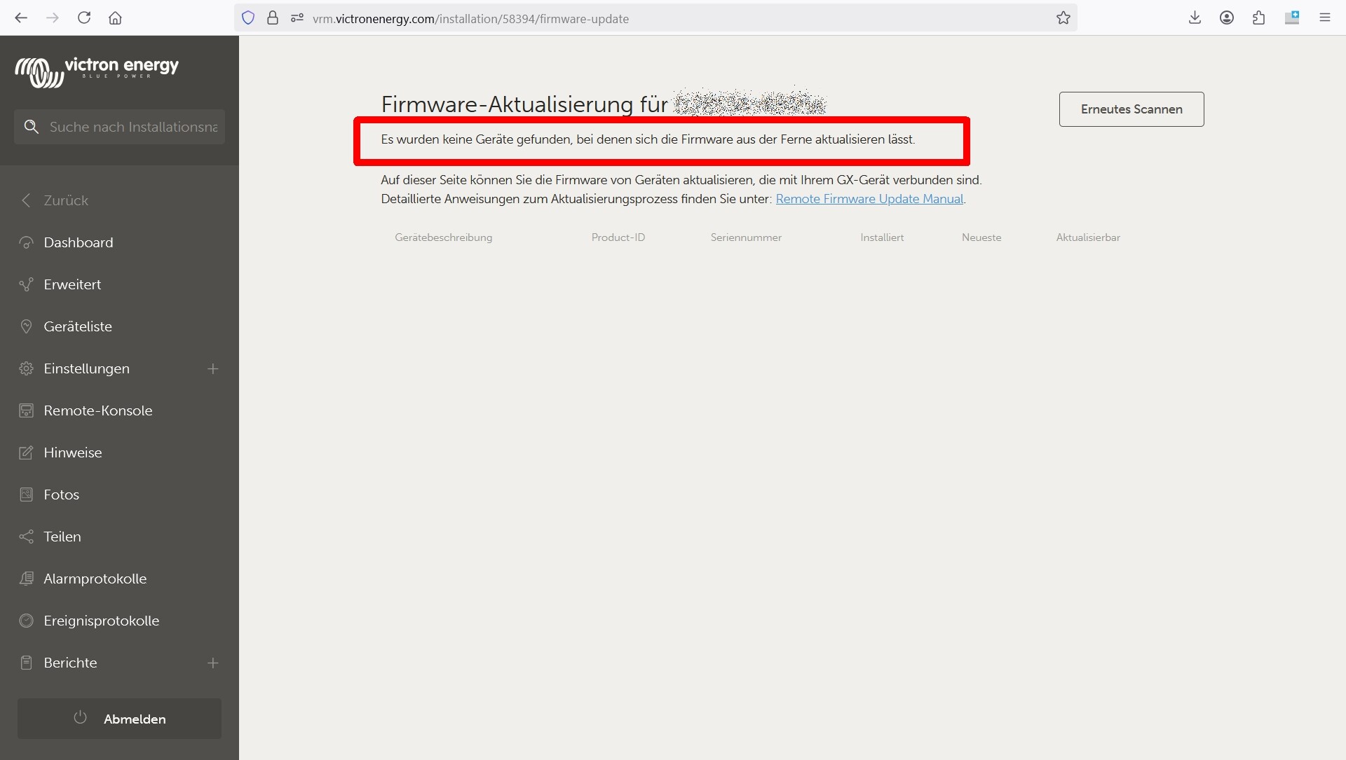

Your message is a bit confusing to me. It seems to me that you’re assuming two different firmware update processes? VENUS.OS? | Multiplus firmware? I’ve done that before, but it was a good half a decade ago. Could you please describe that in more detail? Links for further reading are welcome.
I’m familiar with the “Remote VE.Bus firmware updates” page and the video linked to it.
But I can’t find any devices that I can upgrade remotely?
Can I only perform these firmware upgrades remotely?
I’ve also read the previous page of Remote VE.Bus firmware updates and haven’t been able to find any information on how to proceed NON-remotely.
I’m currently stuck on THINKING and upgrading!
Herzliche Grüße - Ewald

If you start updating one component you always should update all components.
GX and MultiPlus are different devices.
It’s strange that it doesn’t show the MultiPlus in that list, also the GX device should be shown there but maybe you version 2.60 is too old for that feature?
Hello!
Thanks for your time. I think so too, but I’m guessing that this is simply not possible with my old GX version. I could perform the GX update via the Remote Console.
But I can’t find a way to update the inverter’s VE.Bus firmware via the Remote Console.
Is it possible that I can only run this VE.Bus firmware using the MK3 USB interface?
I first need to determine the current VE.Bus firmware version.
I should probably perform the VE.Bus firmware update before the GX update? Right?
Servus - Ewald

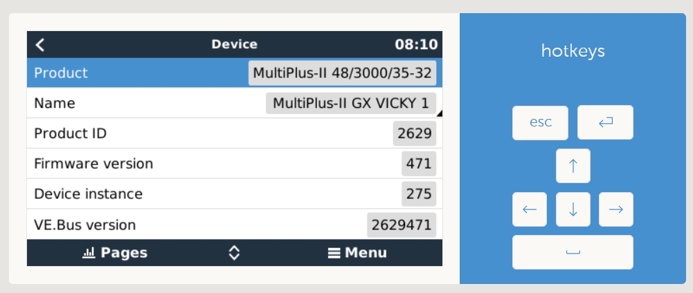

If a VE.Bus FW update is possible via VRM depends on the currently installed version.
In the remote console device list → MultiPlus → details (or something like that) you should be able to check the FW of the MultiPlus.
Read the instructions carefully and watch the video!
The VE.Bus system switches off during the update and needs to be reconfigured after!
If you have a bypass switch you should switch that to grid to prevent unexpected shut downs during/after the update.
I think it’s better to first update the Venus OS.
Hello Matthias! @M_Lange
Thanks for the tip on how to read the version of VE.BUS firmware.
Perhaps I wasn’t looking in the right places or had the right facts searched for. Is there some kind of table that lists, for example, that a certain VE.Bus firmware is mandatory starting with a certain Venus.OS version, e.g., 3.6?
I’ve read a lot of information, blog posts, and PDFs in Victron’s professional section, too. However, I haven’t been able to find any facts about whether an VE.Bus firmware upgrade is even necessary or recommended when aiming for newer Venus.OS version.
I found a PDF contains an email address where you can request the firmware. Would this be the correct, officially designated way to find out whether an VE.Bus firmware upgrade is necessary at all, and which one?
I’m trying to find a solution or answers myself, but I’m overwhelmed by the sheer volume of information, some of which relate to products and versions many years/decades older than my 2020 system. I hope to get some support and guidance here.
Kind regards - Ewald
You’ll never get this now, not even with the most recent venus os firmware.
As per internal failure error, a firmware update from pylontech is in order.
Hello Alex!
Great to know, that I am have no need to try to solve it on Victrons site" :smiling_face_with_sunglasses:
But do you mean, that Pylontech is working on this problem? And I will have to wait for a future update from Pylontech for Pylontech batteries and Pylontech HUBs?
Servus - Ewald
With recent Pylontech firmware (rev. 2 and later) you can obtain extended information over CAN bus from each battery.
But even if you have that recent Pylontech firmware, Venus OS is not asking the batteries for those pieces of information.
Of course, the other reason - the internal error problem - asks for a Pylontech firmware update, thing that their tech department will tell you.
