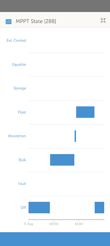

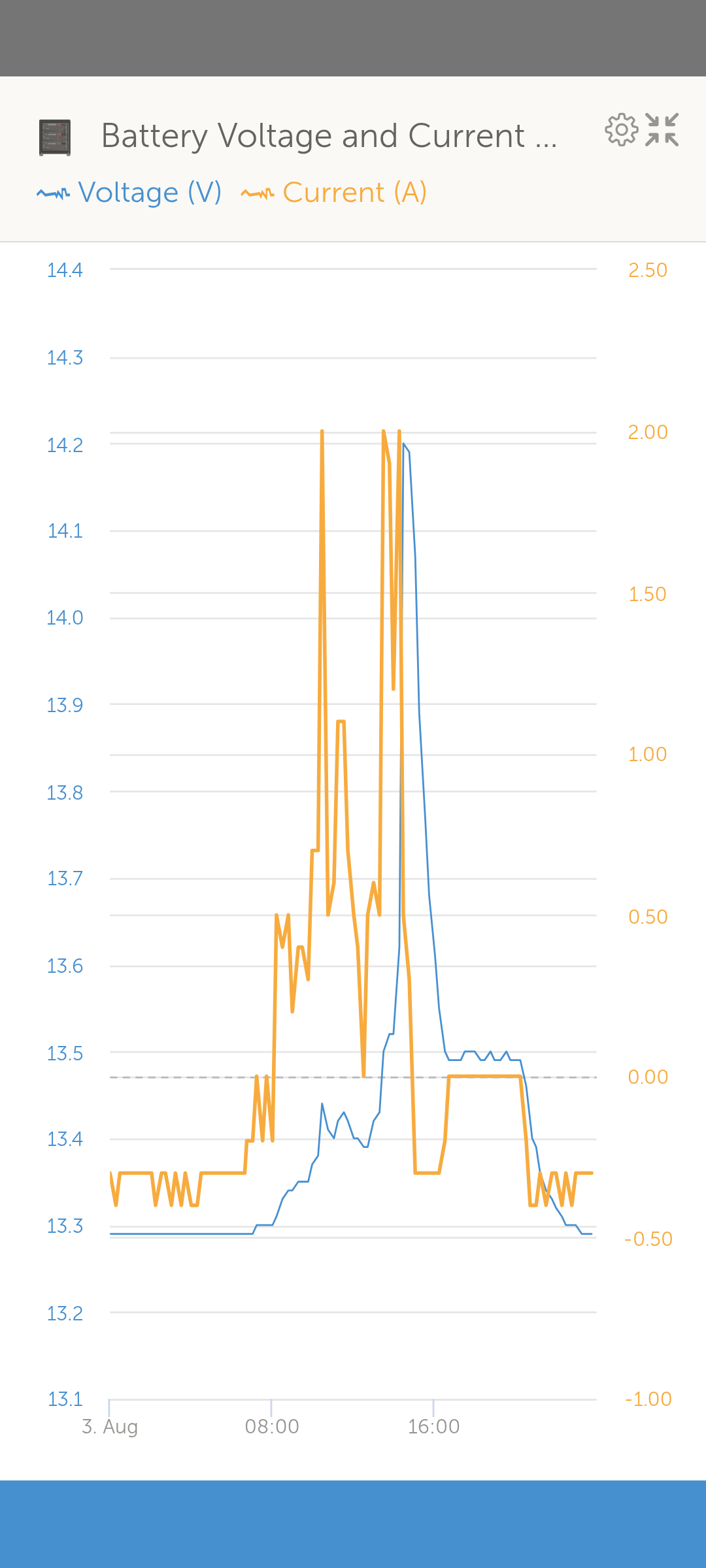

Similar with mine however I’m not worried by it as IMO the do not charge above 80% is a hangover from old technology lithium batteries.
I only have half hour absorption and although it gets to 100% the MPPT then switches off until the battery voltage drops to 13.5v and after that only supplies the load and nothing to the battery unless the load is greater than the MPPT can supply then it part comes from the battery.
Most of the time although it’s sitting at 98% and 13.5v the current is 0A so I can’t see how it’s doing any harm to the batteries.
I do on occasions, if it’s going to be really sunny as now, turn the MPPT off for a few days more because I can than for any other reason.
A typical day
