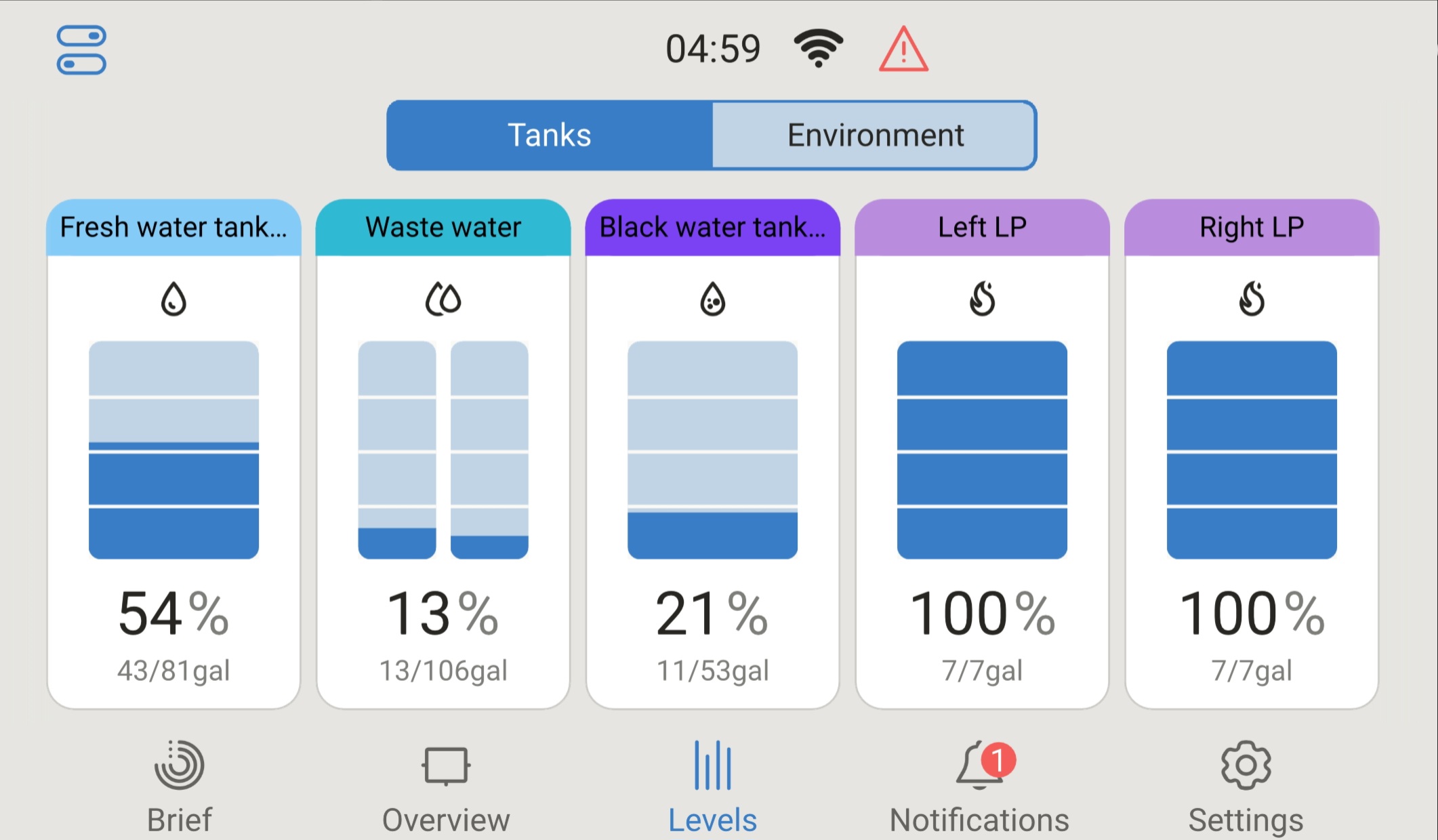

I’m using a Seelevel system integrating with the Seelevel Soul which uses RVC, it doesn’t let you label the tanks, but it does bring in the category. So for two waste tanks they must be grouped together in the tank screen, how can I make them?
Also, it brought in Fuel Tanks, which I cannot hide so they show up even though they are Open Circuit.

For reference, I dug in Saturday and was able to solve the fuel tank issue.
In the Cerbo, under I/O, tank sensors I was able to toggle them off. There are multiple access points to review this that I didn’t look there. Looking and using new UI introduced in 3.6, there’s all devices, there’s connectivity thru RVC, and then integrations physical I/O. Under physical I/O tanks and you can disable there. Looks good now.
Still can’t custom label tanks so have to make due with waste water (1),(3) but will live with that. Ok the bigger Cerbo GX screen the two waste tanks are separated because there is enough real estate.
