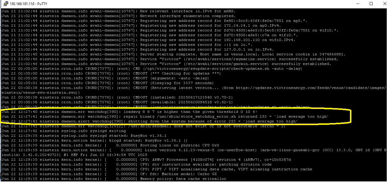

I used Putty to root into my Cerbo and search /var/log/messages for any reports of VE.Can daemon crashing and I saw none Yay! BUT I noticed uptime was 14 hours and went back through the logs and see my Cerbo crashed overnight. Not good, no Alarm or Event logged so IF I didn’t root in I wouldn’t have known. Reporting reboots is a good idea IMO!
Crashed was actually forced reboot due to load being too high so IDK was the Cerbo message from the loss of power or the forced restart overnight?

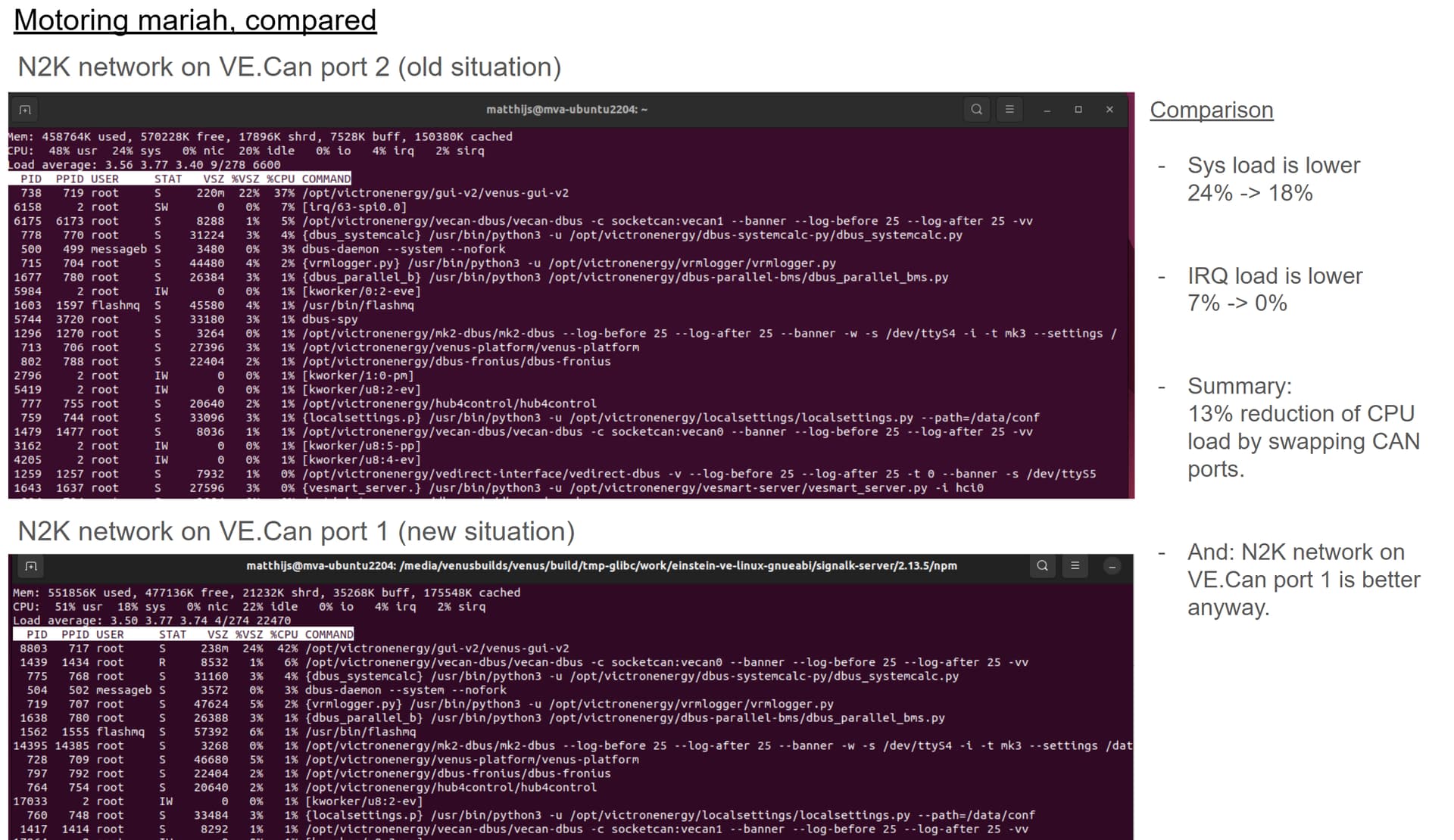

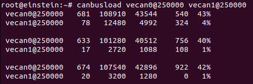

Hey, short update: I logged in just now. Looks like you have your N2K network up and running as I see a similar busload, but as expected its now on VE.Can port 1 instead of VE.Can port 2:
Next I compared the top output, and swapping those canports resulted in approx 13% of CPU savings - nice!
