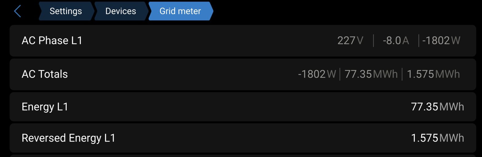

Nothing in my system, which has been online for about 5 years, has changed. However, after after a brief loss of mains thing morning, even though the MultiPlus-II shows power on L1, and is exporting all of my AC-Coupled solar, it is stuck in “disconnected” and all of my AC2 loads are disconnected. I’ve tried cycling the Multi to Inverter only, to off, disconnecting the grid, and nothing fixes it. It just continues to discharge the battery to the AC1 loads, and any AC-Coupled solar (when the inverters are switched on) is exported to the grid.
Could really use some help here, as I can’t get the AC2 loads back on or the battery discharge to stop.
I updated the firmware on the Multi, and the disconnecting finally resolved itself. The downside, now my ESS Assistant is missing and I have to reconfigure.
Re-running the ESS Assistant takes me right back where I started. The system is now discharging from the battery to power all loads, even though the grid is in fact connected. With the AC Coupled solar turned on, 100% of the generated power is back-fed.
I am at an absolute loss here. The Multi continues to indicated “Active AC Input: Disconnected”. This is regardless of setting to use the ET Grid Meter (which is properly detected, and reads the correct outflow of energy that is the surplus coming from the solar).
Temporary fix… I reinstalled the current firmware to the Multi, which removed the ESS Assistant. I can now manually control the current limit, and the Multi no longer thinks AC1 is disconnected, allowing me to power the house and recharge the battery.
This is not normal behavior, and it feels like there’s a bug somewhere.

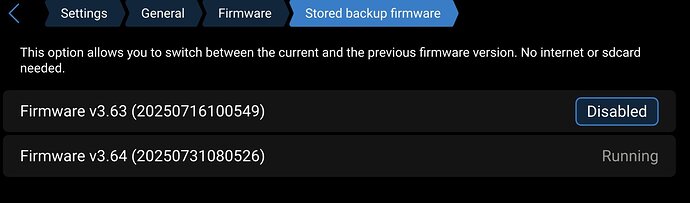

However, I still am not sure why this would suddenly crop up. The problem did not arise after a firmware reset on the Multi, it came about earlier in the morning, without any intervention. Honestly, I think the issue started prior to the loss of mains, given that the battery was already discharged to 54%, and it seems that the GX was updated to 3.64 yesterday…
Have you tried launching 3.63 again, after installing the ESS-Assistant?
That at least would give an indication if it may be related to the cerbo update.
I was planning to try working on it shortly, now that the battery has been fully charged.
To be clear, are you suggesting I re-install the ESS Assistant, and then roll back the GX firmware?
This morning I again reset the Multi, reinstalled the ESS Assistant, then reverted the firmware on the GX back to 3.63 before rebooting. It appears that the issue has resolved. ESS is again functioning properly, and AC1 In is being detected correctly, with the AC Coupled solar being inverted to charge the battery and power loads, or being exported, as expected.
Thanks for the help. Not sure why the Multi decided to not cooperate without being reset several times, or of the 3.64 firmware was even an issue.
