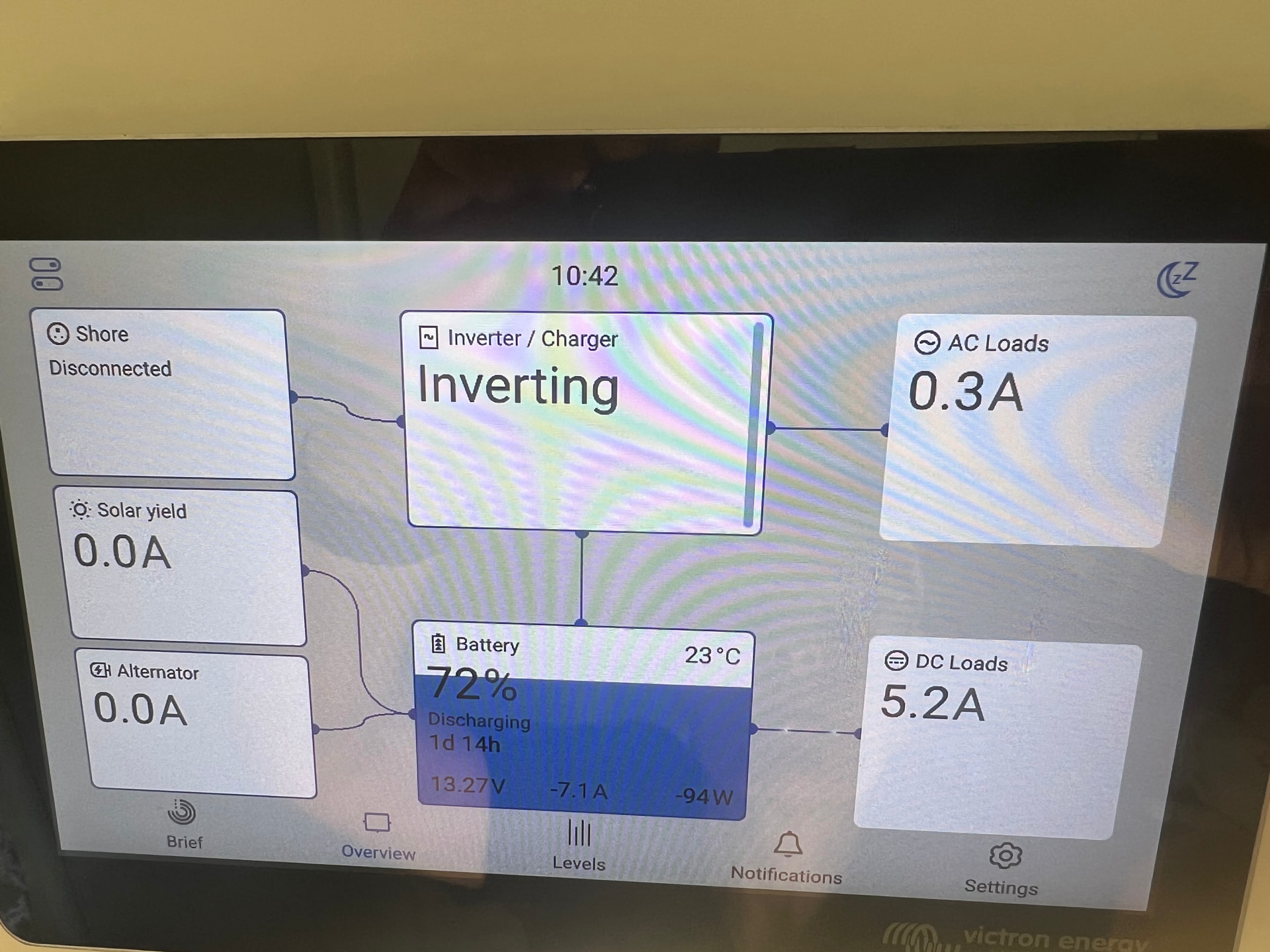

Solar Yield Zero. PV panel state is “off”. Help please
Can’t get the solar panel to charge battery. Can anyone help please?
Please give us a little bit more info about your system. Configuration, hardware, etc.

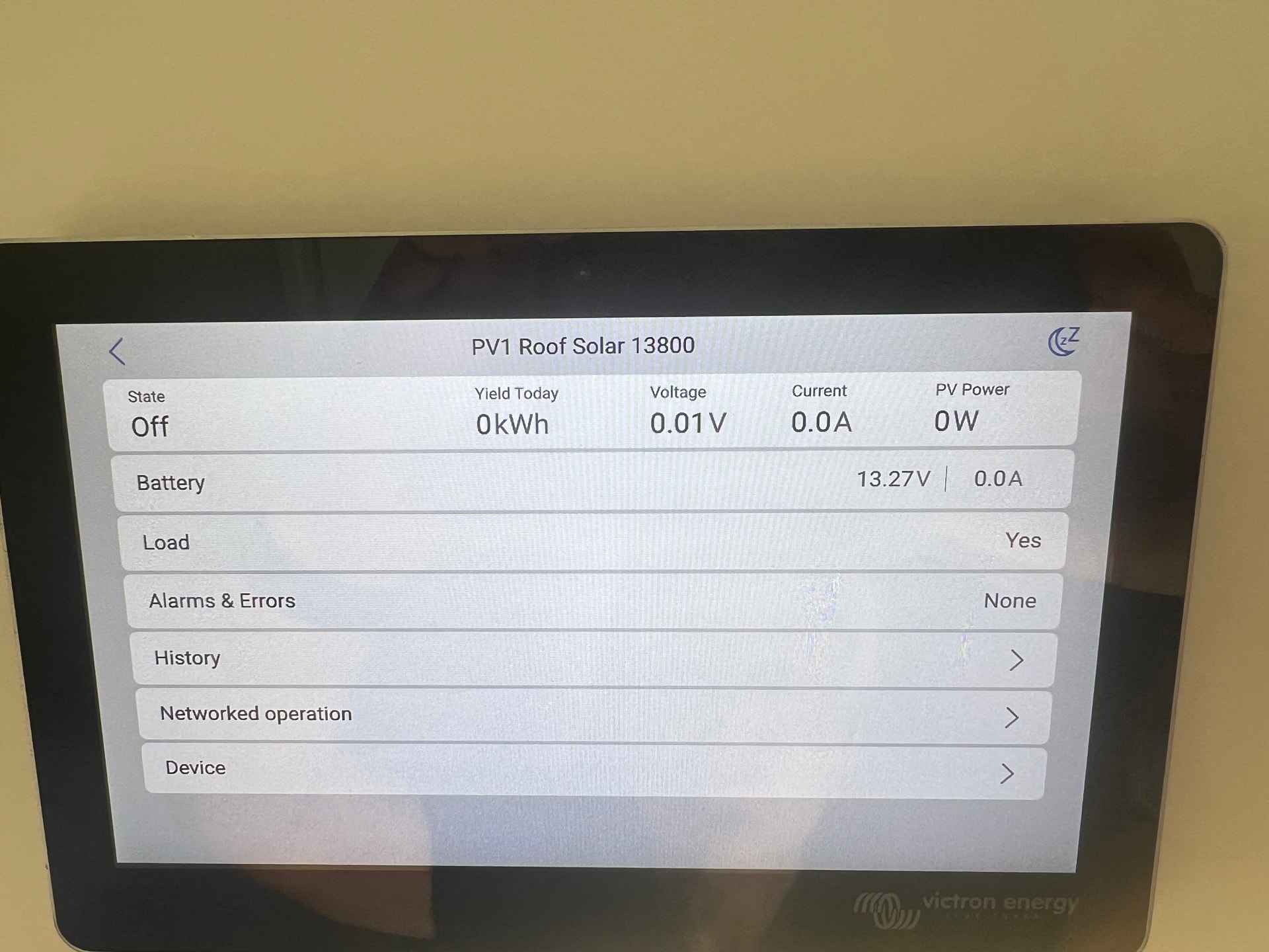

Is it a SmartSolar with Bluetooth that you can connect to with your phone using the VictronConnect app. That has a button to click on “Why is solar off”.
From your first screenshot there is no PV voltage. This is often caused if the cables between the solar and the MPPT are no longer connected, broken connections, loose connection, blown fuse, breaker or isolator off.
