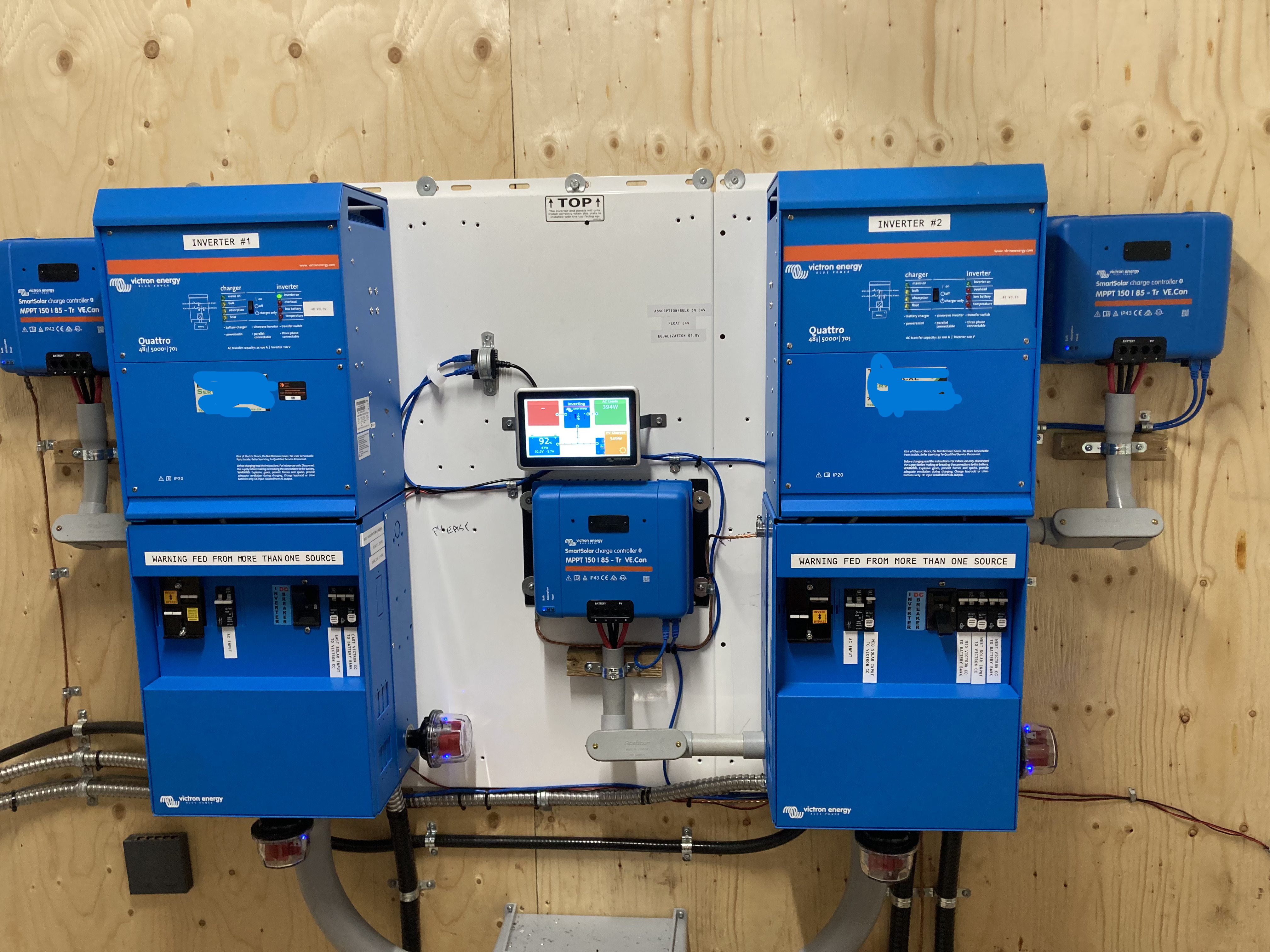

Small Off Grid Systems
Here are some of our small off grid systems we have made for our customers.
No wiring ducts?
For some codes it is only stated that wiring must be double insulated and supported with x distance between fixings and protected from environmental damage.
DC cabling is double insulated and there is good wiring support there and it is in a box. Pretty much all the bases are covered.
Thanks for the comment! In Canada this passes all Electrical code. Our units are in a sealed metal cabinet, so it’s considered to be mechanically protected and safe
