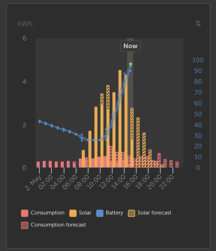

Since this beta 3.60~68 my SOC forecast is not shown anymore.
Also restarting the vrm android app doesn’t fix this.
I might be wrong here but this might be related to changes in VRM (the portal doing the processing and graphing) and not so much in VenusOS (doing the logging and device control).
I found out that the problem shows up when date picker shows todays date instead of the word Today. Don’t mind the missing solar forecast, I did reset while searching for the cause of this issue.
Thanks to @rvdh for mentioning that he had “Today” in his screen and saw my forecast and I didn’t while I had today’s date on my screen.
