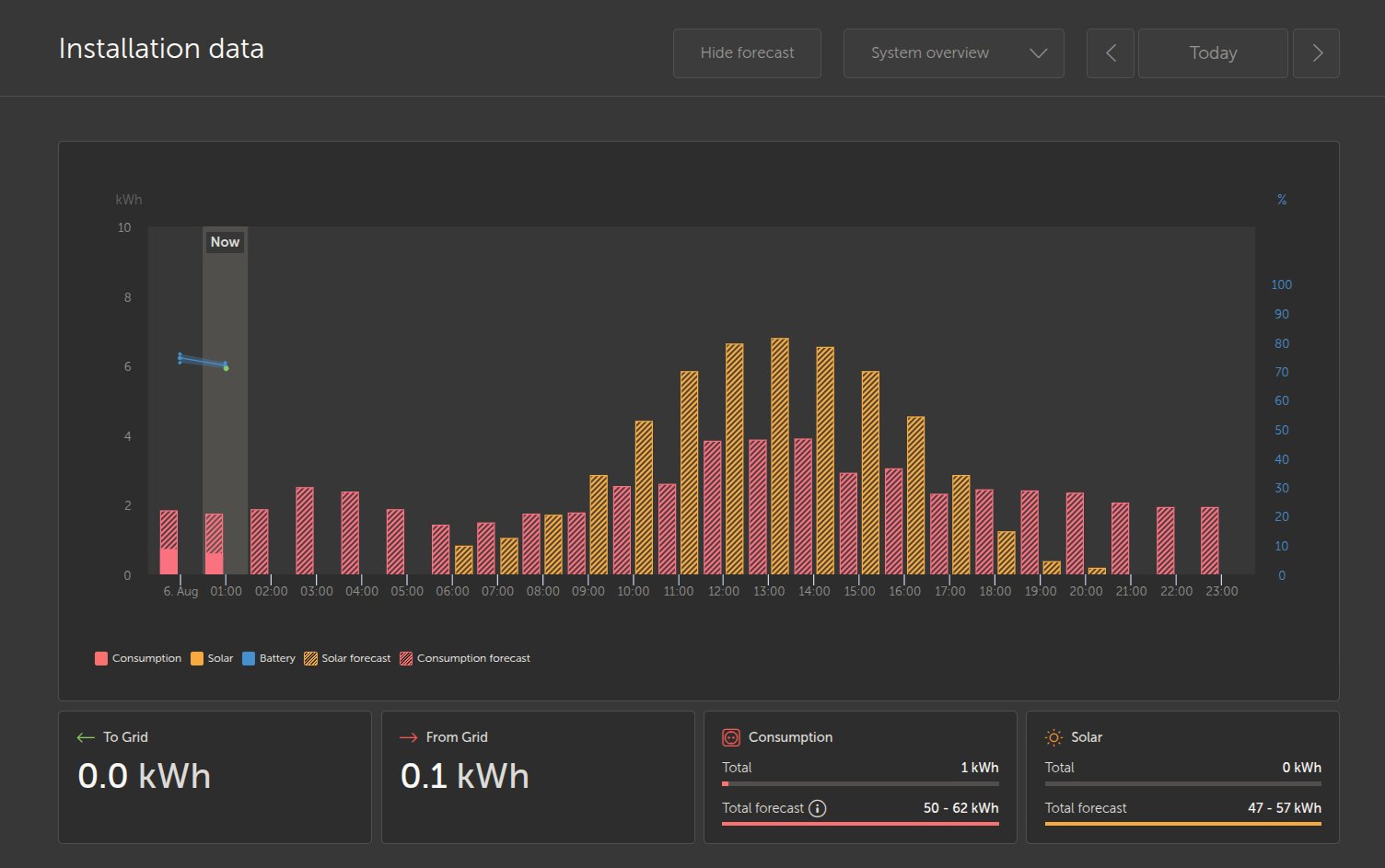

VRM Forecast data doubled(?)
My forecast data from the VRM dashboard (under Installation data > Overview) currently appears to be implausible, showing roughly double the correct figures, for both Solar production and Consumption.
The data displayed in the graphs reflects that in the totals. I also get the same figure for Solar production forecast from an API call (~55 kWh) - (this shows a doubling for both the MPPT and the FoxESS inverter on AC Out)

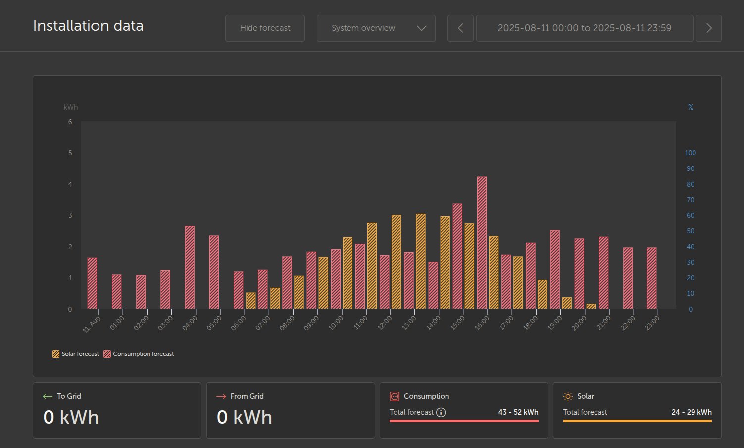

Clicking forward in time on VRM yields similar results, until it gets to the 11th August, when the Solar appears feasible again, with the Consumption following suit from the 12th onwards.
All historical data from the CerboGX appears normal (I log everything to influxdb).
Anyone else seeing similar, or is it just me? I’ve been using the VRM forecasts for setting my overnight charge targets (because they’ve been so accurate and reliable so far), hence my noticing.

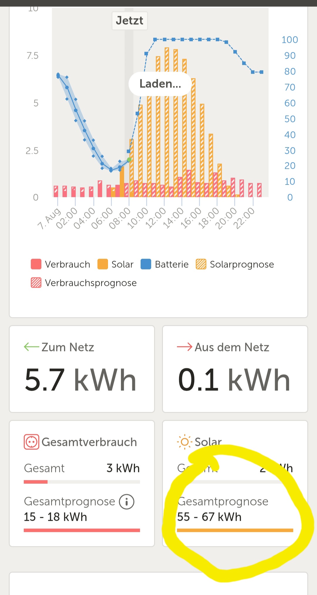

As of now (05:45 AM local time), the forecast in VRM for my location for today is way too low (predicts 45 to 55, should be in the range of 100 to 130)
Maybe it now needs some time to make new calculations based on the current consumption/production?

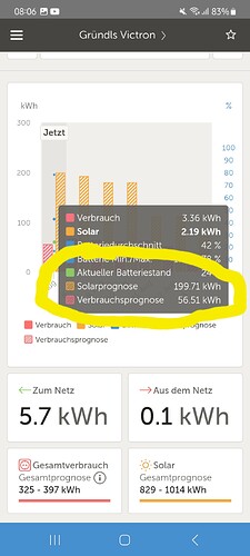

Indeed, there is still a problem with forecasts!
For today it predicts about 60 kWh:
But if I look at the next 7 days, it predicts almost 200 kWh for today!:
