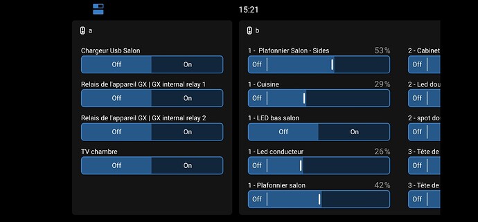

Everything is working now, indeed. My 7 Shelly RGBW firmware 2.0 devices are correctly named, and the channels are finally appearing properly. Thanks to the devs.
Do you have access to the device 4 inputs? I can’t seem to find them anywhere.
Yes, access to the four channels that need to be enabled on the “Integrations” page, under the Shelly section.

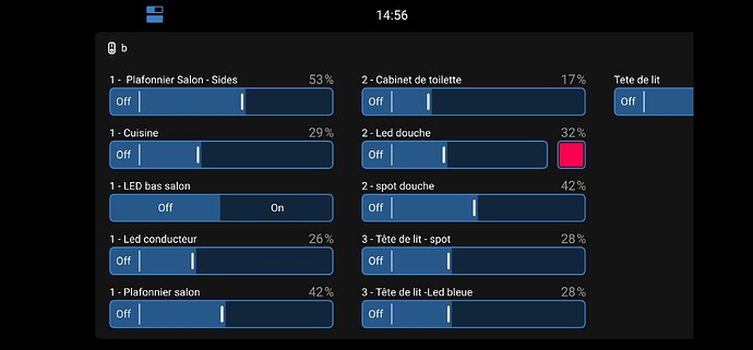

You have input channel details here?
Have you configured the Shelly RGBWs in “light” mode in the Shelly app?
I don’t see a “light” mode. I have the output set as an RGBW driver and 2 of the 4 inputs enabled as detached.
Thank you, that took a bit to convert the picture from French. It appears you have yours in 4 channel mode. In that mode I do see 4 Outputs, what I’m missing are the Inputs.
