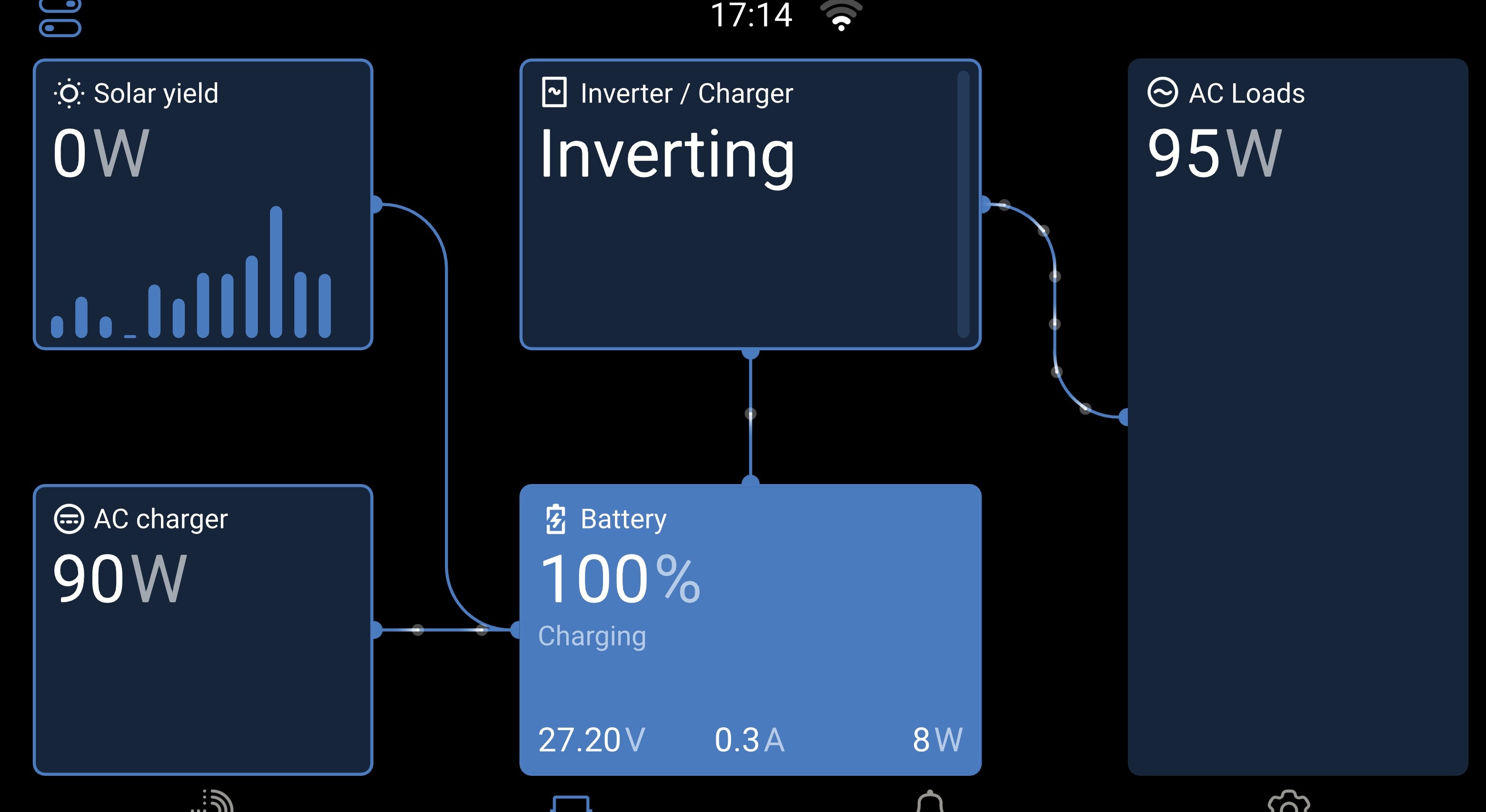

Im trying to prioritise a 2x smart solar charge to 25.6v lifepo4 managed by cerbo S GX and with 712 battery monitor. They are set at the standard 28.4/27.2 absorption and float. Ive recently added a wind feed which for a number of complicated reasons is having to come back in through a blue smart charger (power measured through separate shunt but all showing on display. Im trying to ensure the solar (much bigger supply) is always first call until going off. I’m assuming I lower the absorption and float on the victron blue smart charger (done to 28.2/27.0) but this doesn’t seem to do anything and the AC load is always defaulting to the blue smart charger.

thanks that’s clear. I think I had done that but the priority solar feed was in float so I guess it drops to the blue solar in absorption and doesn’t drop out of that until the blue solar depletes the battery from the wind system which isn’t ideal. Would be nice to potentially auto block the wind from charge during the day so that it just tops up its battery before night swapping over to supply the larger bank. Unfortunately I have some gadgets on the wind inverter (DC to AC) (at the wind farm “sub station”) and they keep getting knocked off on depletion. Guess I could use a smart plug
