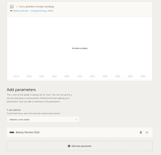

Hi Everyone, sounds silly but somehow i cant find the right way to monitor the Total amount of kWh that went in and out of my (Pylontech) batteries.. anyone got an sugestion how to get this data in VRM? :sweat_smile:
Pylontech supplies that info, but victron don’t collect it directly from BMS in the current configuration.
As “v” in vrm stands for victron :slight_smile: you will see that info only from their devices, like shunts & co.
