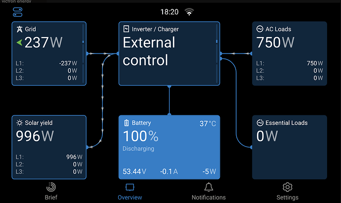

Through the VRM portal I can launch in my browser the new remote conole (app?) as an overlay to the VRM website.
Anybody found how to launch this in a separate browser window (without the VRM site background)? It would allow it to run in a browser kiosmode on a dedicated toutchscreen.

Cant you browse to the local ip adres of the gx and select gui 2 in the remote console? That works great for me, or use the suggested android gx display method, thats noce too

It should be accessible at https://venus.local/gui-v2/ (or by using the IP of the GX-device or even http:// instead of https://) from within your home-network.
If the GX-device is connected by wifi, make sure your wifi-router allows connections to/between wifi devices! A lot of modern ones deny this by default. LAN cables should always work and some routers can be configured to allow connections → wifi devices.

I’ve got an old Android phone that I use to connect to direct (Cerbo GX access point turned on).
Then my Cerbo GX also connects onto another WiFi network (my phone’s hotspot)
I don’t often use the standard dashboard as I’ve set up node-red to control system.
It works lovely, so much that I rarely use my Cerbo GX screen as my phones are always closer.
Ordered a cheap 70 EUR android tablet and choose the GX Wifi route, works like a charm compared to my “sideloaded Amazon Fire” with Fkiosk, got the Fire setup to work but it was not very stable.
