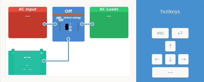

Hello to all,
i need a help regarding battery status issue with my new system.
System configuration:
Victron Multi RS Solar 48V/6000VA/100A-450/100/230V Inverter
Cerbo GX MK2
GX Touch 70
2×US5000-1C + 4×US5000 ( firmware not updated )
System was put online June 2025 ( island configuration )
Attached picture shows the status. ( bluetooth shows all details like it should )
All the wirings are made by the book and i don’t know what else to do.
Thank you in advance.
