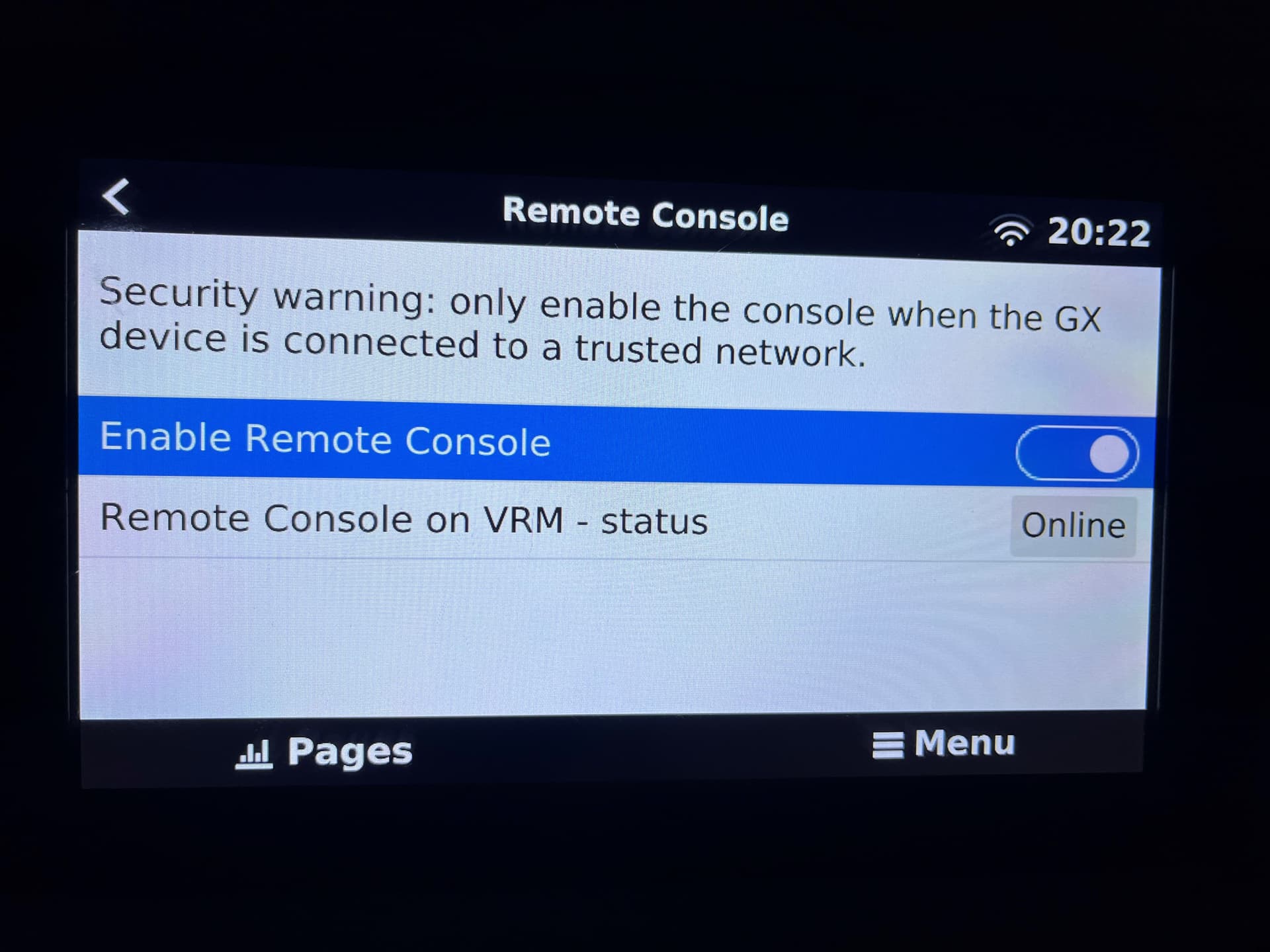

This is the location for enabling the remote console in GUI v1:

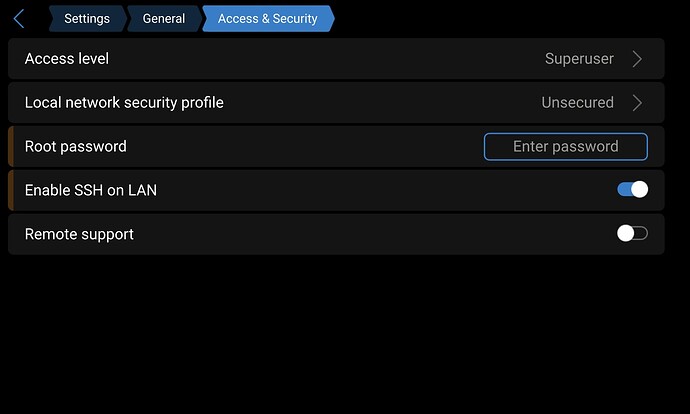

Possible location for location for enabling the remote console in GUI v2. It doesn’t seem to fit in any other category. If not here, the where. I’ve checked.

The cerbo manual has everything you are asking for in section 4.4
https://www.victronenergy.com/upload/documents/Cerbo_GX/140558-CCGX__Venus_GX__Cerbo_GX__Cerbo-S_GX_Manual__non-CCGX_3_50_-pdf-en.pdf
Old settings no longer exist in the new multi user access model.
You need to choose the level of access and user type to control what can or can’t be seen.
VRM settings can also be configured to restrict access from the internet (settings → VRM).
