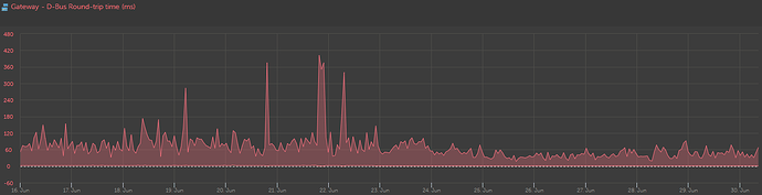

@OGPS I removed SetupHelper and GuiMods on ~June 23rd and have not had another shut down since. I hope the new MKIII will be a supercomputer, I will be the first to preorder it

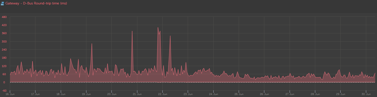

Also, I temporarily disabled Node-RED on June 24th 8am or 25th? Dbus round trip times have improved. I changed widget settings to reflect accurate peaks and was surprised to see peaks towering over 400ms!

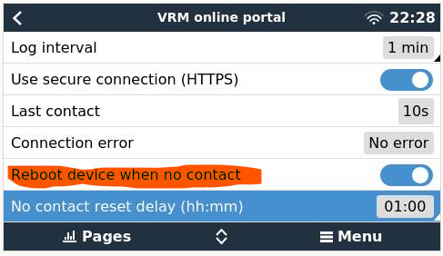

Does your watchdog example refer to this GX no contact setting?

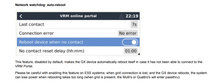

Edit - Although not using ESS here, I did find a vague explanation in the GX manual
