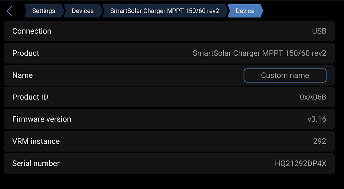

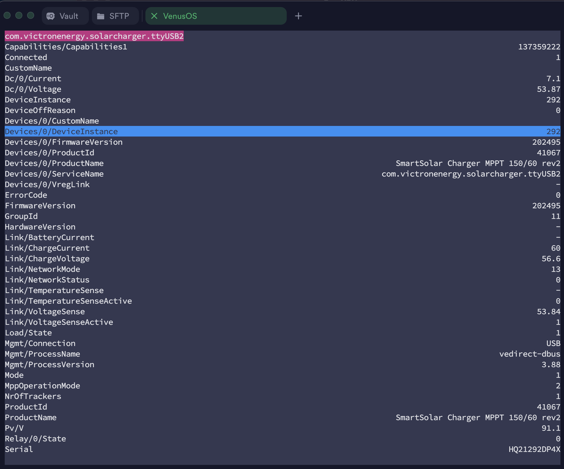

Hi, thanks. Can you post a screenshot of the menu where you tried to change that?
And which path/service in dbus-spy?
And a GX screen, ie Victron hardware?
Or in a webbrowser?
Hi
Here are the two images. I’m on a Pi4 and as stated, this worked before.
in dbus-spy I’m able to enter a new value after selecting “DeviceInstance” with Enter, but the new value is not saved.
in venusOS guiv2 I cannot even enter the field “VRM Iinstance”
