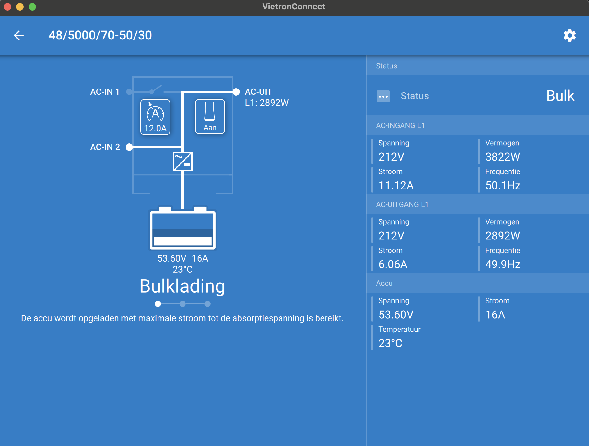

It’ sometimes gets even stranger. This week I noticed that in another harbour where we do have 16A conection out fuse trips.
The Quattro’s are set to 6A each, so 12A max but still it draws >4kW from the input, tripping our internal fuse at the socket.
After connecting to the VE.bus I see this weird data with wrong calculations (see screenshot I took).
AC-in-1 212V and 11,12A (which is below the 12A limit indeed) but 3822W which is quite different then 11,12*212=2357Watt.
This is really strange also because it reports AC-out as drawing 2800Watts when no load is present, it’s only charging our battery (MG LFP304)
