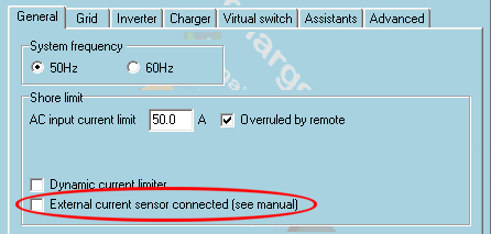

In your design isn’t necessary required the external grid meter, just simply external current sensor (CT). Have you installed it & activated in VE config? If so, then you first need to focus on the resistance measurement of each chain AC IN / AC OUT.

I have configured the grid meter in the VRM Portal not in VEConfig, is there something I might have missing?
At the moment, I have not installed an external current sensor

You also need to use an external current sensor CT
UPD: External current sensor connects only to Master

Where should the external current sensor be positioned? On the AC input of the master only, or on both the master and slave? Or upstream as a grid meter? I have an ET112 grid meter.
