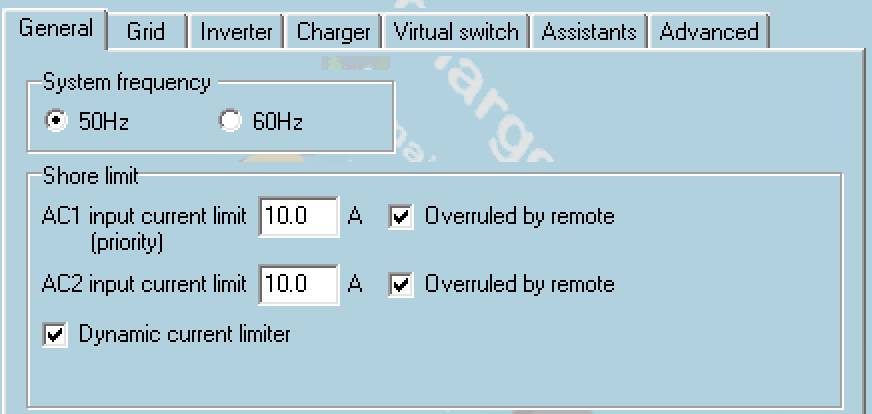

Thank you! All these settings, Weak AC, Dynamic limiter and Max current have been set earlier.

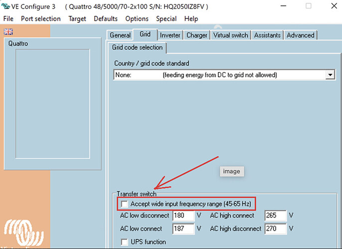

Can you post a screenshot of this setting?

Lol. Usually that is switched on when there are troubles with generators.
Yours must be a good one if it can synchronise without that being enabled.
By the way you can leave it unchecked in your base program for normal operation.
Modertaor comment.
Answer edited due to use of AI.
I am aware. Also no AI generated or derived answers please. It is against community guidlines.
The wide frequency is documented for use onky with troublesome generators. If you aren’t having trouble then you don’t need the feature.
By the way it is not deactivating the transfer switch when you disable wide frequency, it is just changing how the inverter reacts.
This is the main input relay and is the clicking sound you hear on generator connect. So there would be no transfer from in to put without it. The AI is incorrect.

You have done some pretty extensive searching for the problem.
This is not what is happening when you uncheck wide frequency.
The transfer switch is the primary relay. What you are doing is changing what conditions the transfer switch connects or disconnects.
