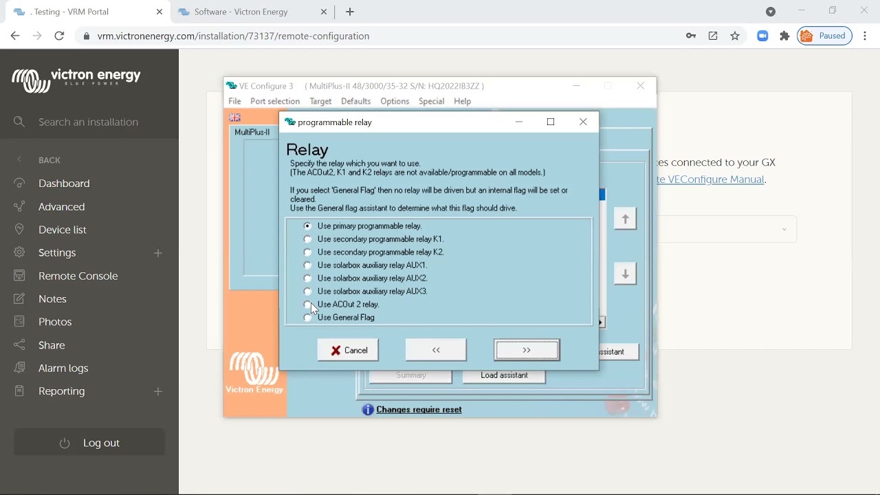

Yes, I am looking to have that second AC output always on when I am inverting. (Not plugged in) I will search out those videos as I haven’t seen one of those yet.
If you are a reader not a video watcher…
Ve config…
Assistant tab
Add assistant - Relay - programmable relay
Click on the assistant created (it will be in italics) - then start assistant then
Use ac2 out relay - set relay to on - click next (double arrow pointing right) all the way through - and done.
It will always remain on after you send the config to the inverter.
Wow, Thank You for that. Looks like what I want to do is possible using the GUI. I would like to have it on 100% of the time, while on SP or just using the Battery. Just providing power all the time on both outputs. Since turning this functionality on is a bit comber-son I am wondering if they (Victron) doesn’t want that output always enabled for some reason? Other than me draining my batteries to 0 SOC with this turned on, is there some other reason I should not do this? My personal opinion is this should be on by default and you’d have to go thru this process to turn it off. -Bill
