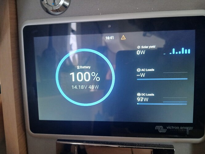

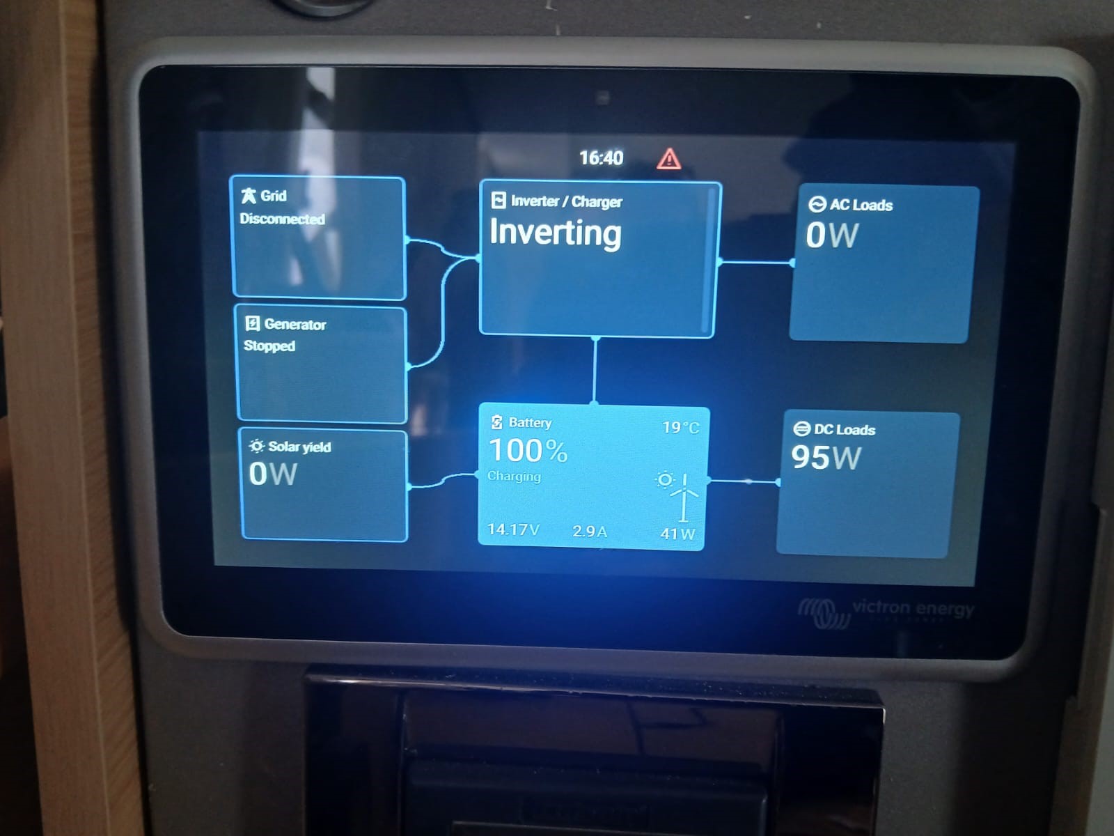

The batteries are full, and the loads are off. Apparently in the meanwhile we found a “ghost” BMS in the software and after we removed it it started working. After a little while though, it went to low battery again. Off and on again and working. It may be a problematic inverter

coming back with the topic, it seems that after the extra installation of the quattro, we had to update of course all the machines to the latest version, and do a factory reset to the ekrano and reboot the whole system, so that it starts as a whole, and now it works perfectly.
