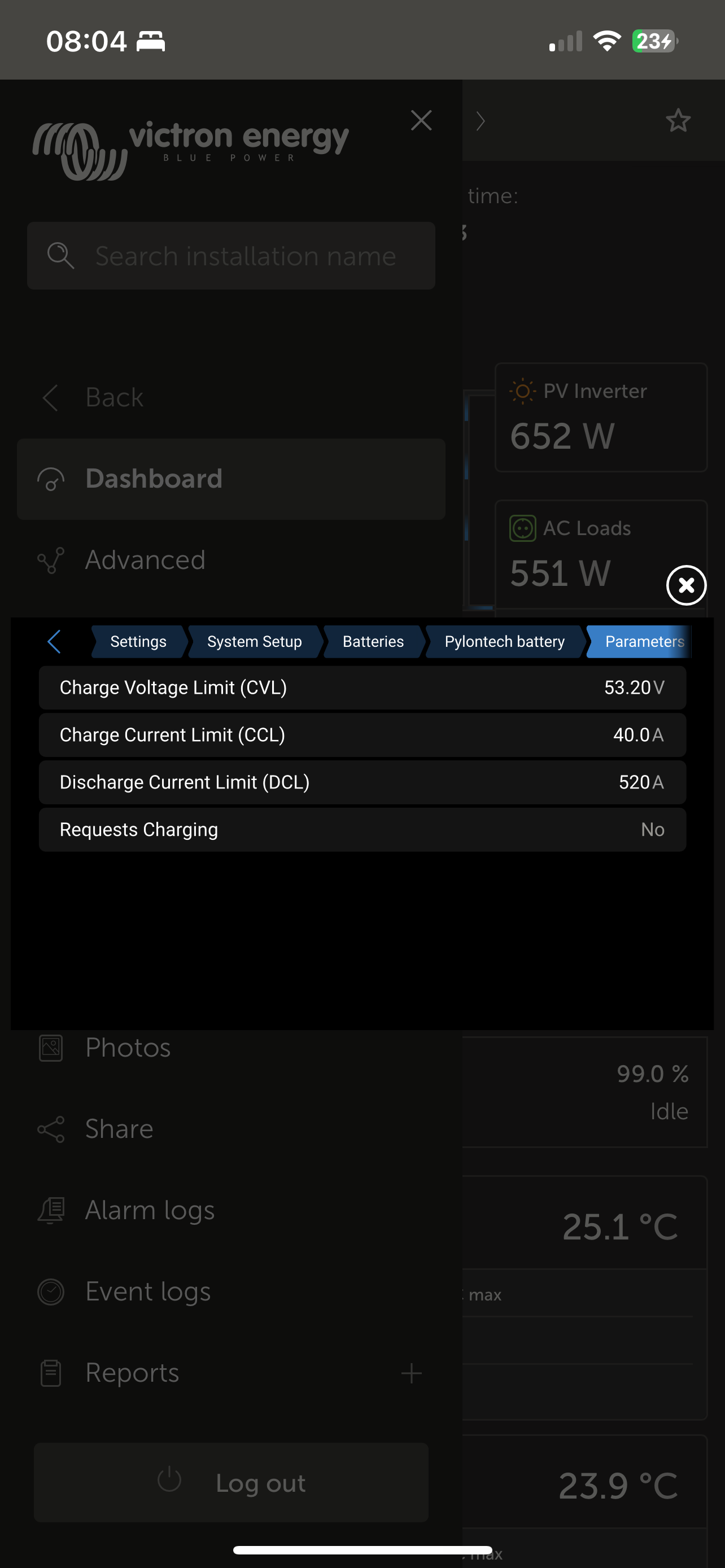

@lxonline CCL doesn’t seem to move from 120A I’m back to 99% and the min and max cell voltages have moved to .448 lowest highest .493
At @lxonline is this what you’re talking about when saying the CVL increases? But this is still set to the Victron settings of 52volts yes the CCL has started to decrease

That is what i was referring to. The battery requests higher (no you don’t want it that high). You see on your screen shot the CCL is 40A there @Daza

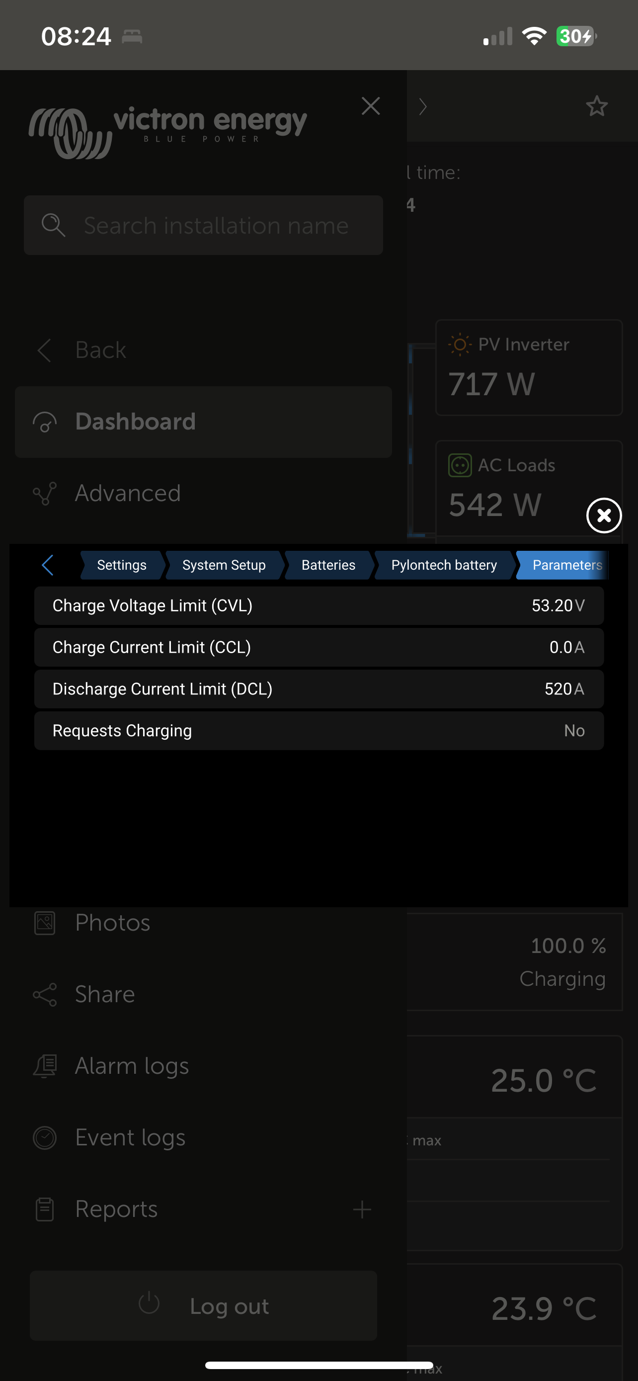

Yes CCL is now 0.0
Gonna have to try to get to grips with these widgets but I noticed it in home assistant that SOC didn’t get to 100% but now it is in both Victron, pylon and home assistant. Could it be that it just needed a bit more time to balance the packs? What I hope it doesn’t do is go outside my 6 hour window in order to achieve the 100% will have to keep an eye on this for sure but solved for now. Thanks to you both @lxonline @alexpescaru much appreciated
