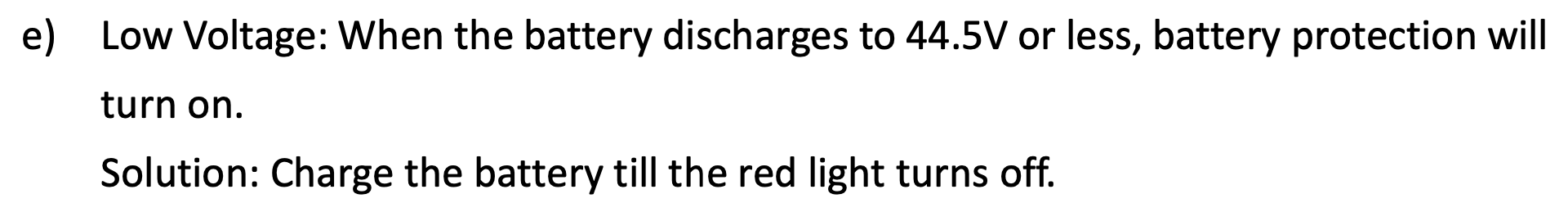

This is an interesting chart. The Pylontech US5000 manual says the battery will shut off at 44.5V which is much less than what your image shows (if I’m reading it correctly it shows an empty battery at 48V).
Those ranges on the graph are set manually in such way that they are easy to read comfortably.
There is no correspondence/sync between the ranges and/or parameters.
The 48V<->53V range window is just taking the same space on the graph as the 0<->100% SOC, the same as the 0<->150A range or -70A<->70A range.
