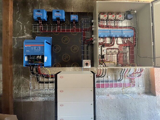

Here are the details. We have a solar installation consisting of 24 620 W panels connected to 3 VICTRON MPPT charge controllers (2 250/100 controllers and one 150/35 controller), 1 Quattro 48/15 kVA inverter and 4 BYD 5.0 kWh lithium batteries.
Twice now, one of the charge controllers has started shutting down and the display goes blank. So my question is: could not connecting the panels to earth be causing this problem?
Illustrative view of the installation

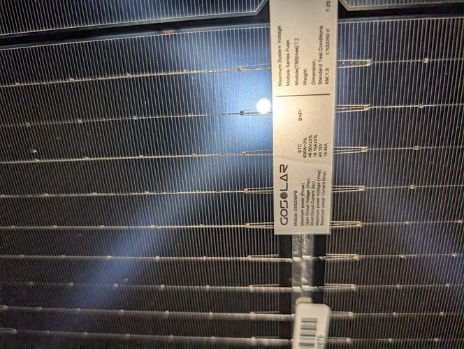

Your per panel voc is a bit high for 5 in series… Lower temps and cloud edge effect will mean that overshoots the voltage max. An basically breaks one of the two main sizing rules.
Run your panel config through the calculator.
Yes, the series Uoc of the 5s strings is just under 240 V!
Did the failures happen in cold weather or in winter? (Worst case is in spring: the modules are cold in the morning, and irradiance can easily reach or exceed 100% to 120%!)

You should not ground PV side cables.
On the regular Victron MPPTs the battery negative is the same as PV negative. So if so grounded the battery negative, automatically also the PV side negative will be grpunded. Additional ground connections will introduce ground loops.
On the RS line of MPPTs the PV side is isolated, including an isolation resistance check.
You can ground the frames and underconstruction. Depending on region/electrical codes its not optional.

You got three 48.5Voc panels in series on a 150V MPPT. Id say classic case of overvoltage. I suggest to use a 250V MPPT instead.
Also use the MPPT calculator, its there for a reason.

Now to the 250, is it completely dead, not reachable via VE.direct or bluetooth anymore? Any other symptoms, like a blown fuse?
At the moment, the controller won’t turn on anymore. There’s no way to view the history, which is why we’re trying to find out what could be causing these sudden shutdowns.
Does it still receive battery voltage? Have you checked with a multimeter? Is your cerbo connected to VRM, does it perhaps show something in the advanced graphs? If you say it “shut down” does that mean ir returns to normal operation after some time or its dead for ever?

For instance 3x of those panels in series into victron mppt calculator give 152v @10c ( highest low temp calculator allows)which indicates clear design issue.
