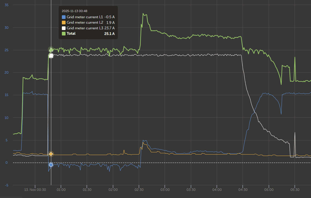

I am trying to figure out which setting limits my Multiplus charging the battery when I am also charging my car.
The MP is on phase 1 of my 3 phase system, the car charges on phase 3.
I have multiphase regulation setup to ‘Total of all phases’, and Peak Shaving to ‘Always’ 25A import and 25 export per phase (DESS also active, inverter max is set to 25A)
But this is not behaving like I would expect, in the picture below you see my battery starts charging (blue line), but when my car kicks in (white line) it stops charging, and instead starts discharging. When looking at the green line (total) I looks like its trying to keep the total to 25A instead of per phase. It stop discharging when it reached it min soc, and only resumed charging when the total dropped below 25A.
I would expect Peak Shaving to work on a single phase, and not the total.
And here you can see it’s ignoring my DESS schedule (white = schedule, yellow = soc)
