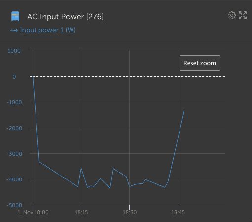

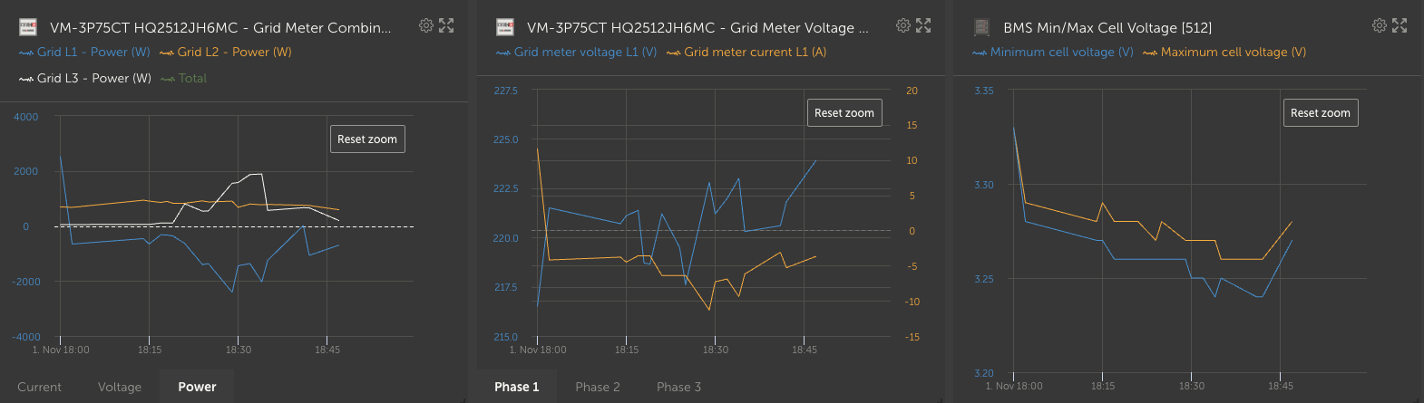

Hi,
Recently installed my Victron system (1x MultiPlus-II 48/5000/70-50, 4x Pylontech US5000-1C - 48V 4.8kWh, 1x Cerbo GX MK2, VM-3P75CT energy meter)
I have 3 fase grid 25A. My Victron is connected via AC in on L1. I don’t have anything on the AC out.
Every Saturday, when my wife starts to get cooking and fires up all possible appliances at the same time, I get multiple Overload messages. I don’t understand why the Victron tries to give more then it’s capable of or even how to understand this error message. Any help or ideas would be appreciated!
