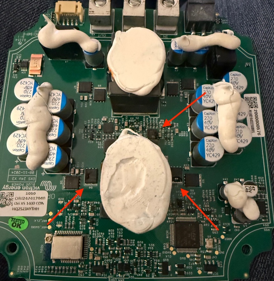

@pau1phi11ips yes we have undertaken a lot of investigation over several boats in several configurations. We have had some that continue to work. We can find no single thread causing the failures. We do have some boats with them working fine. We have had them fail quickly or we have had them fail after a few days. We have worked with our dealer to establish a root cause for the failures. We have had them fail such that the MOSFET switching has blown the tops off the chips and we have had them fail in a less spectacular manner. We also cannot find any correlation between batches manufactured at the same time. I have added a photo of a unit I pulled apart in an effort to try to find out what was happening. Note the tops blown off the chips as pointed to by the arrows. Not all fail in this manner.

Then I don’t have anything to contribute :laughing: we haven’t had any failures yet, but we likely have a smaller sample size to compare than you do. I would suggest that you craft a letter with data (i.e. xx number of failures out of xxx sold) and ask them to send up the chain. You might get Victron’s attention here, but I can almost guarantee you will if you get your distributor involved.
