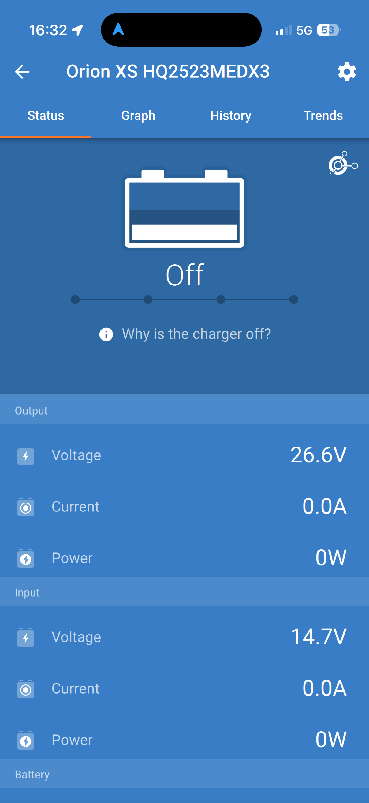

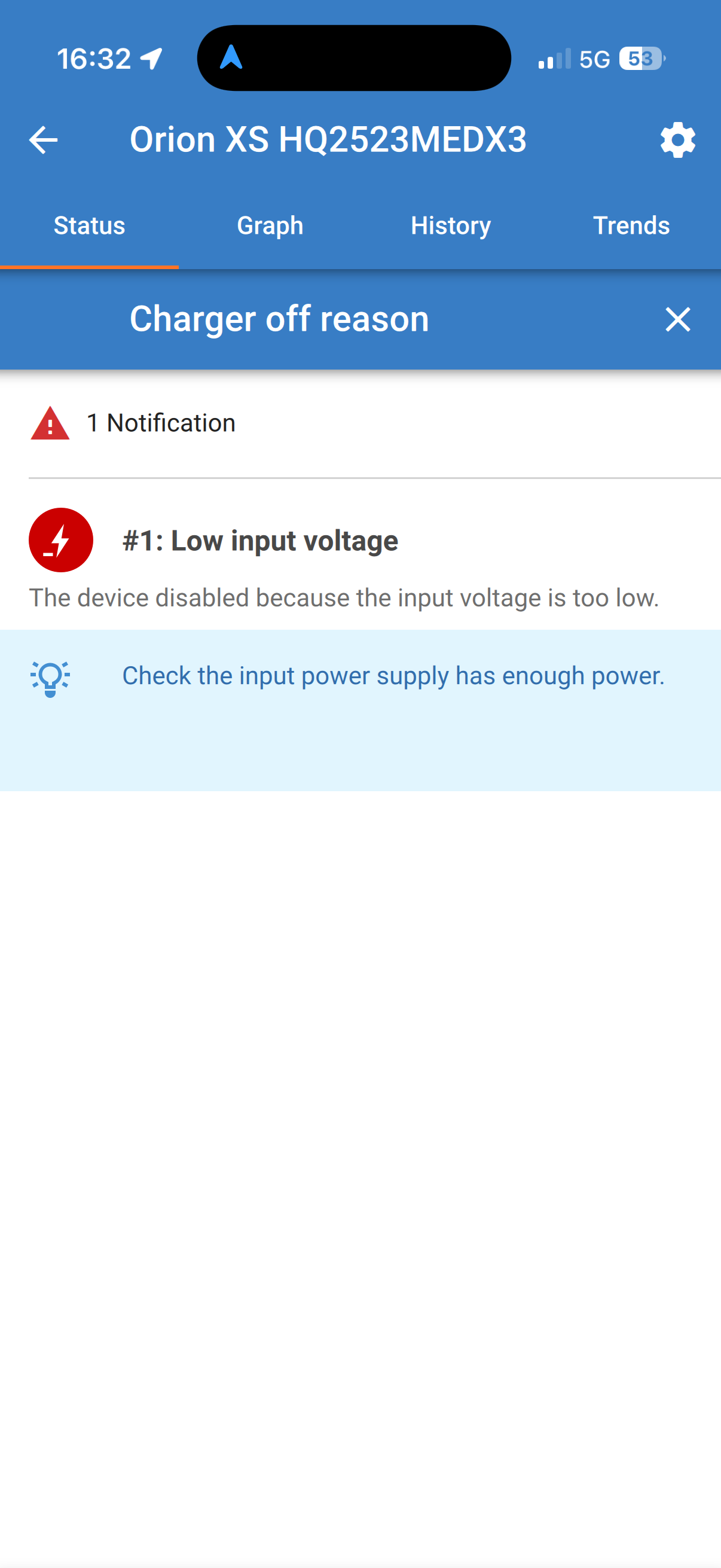

Orion xs 1400 not charging. Voltage too low

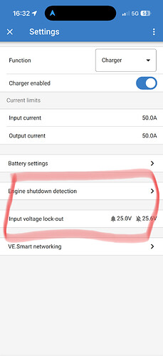

I replaced 2 x orion smart 12/24v 15a with 2x Orion xs 1400.

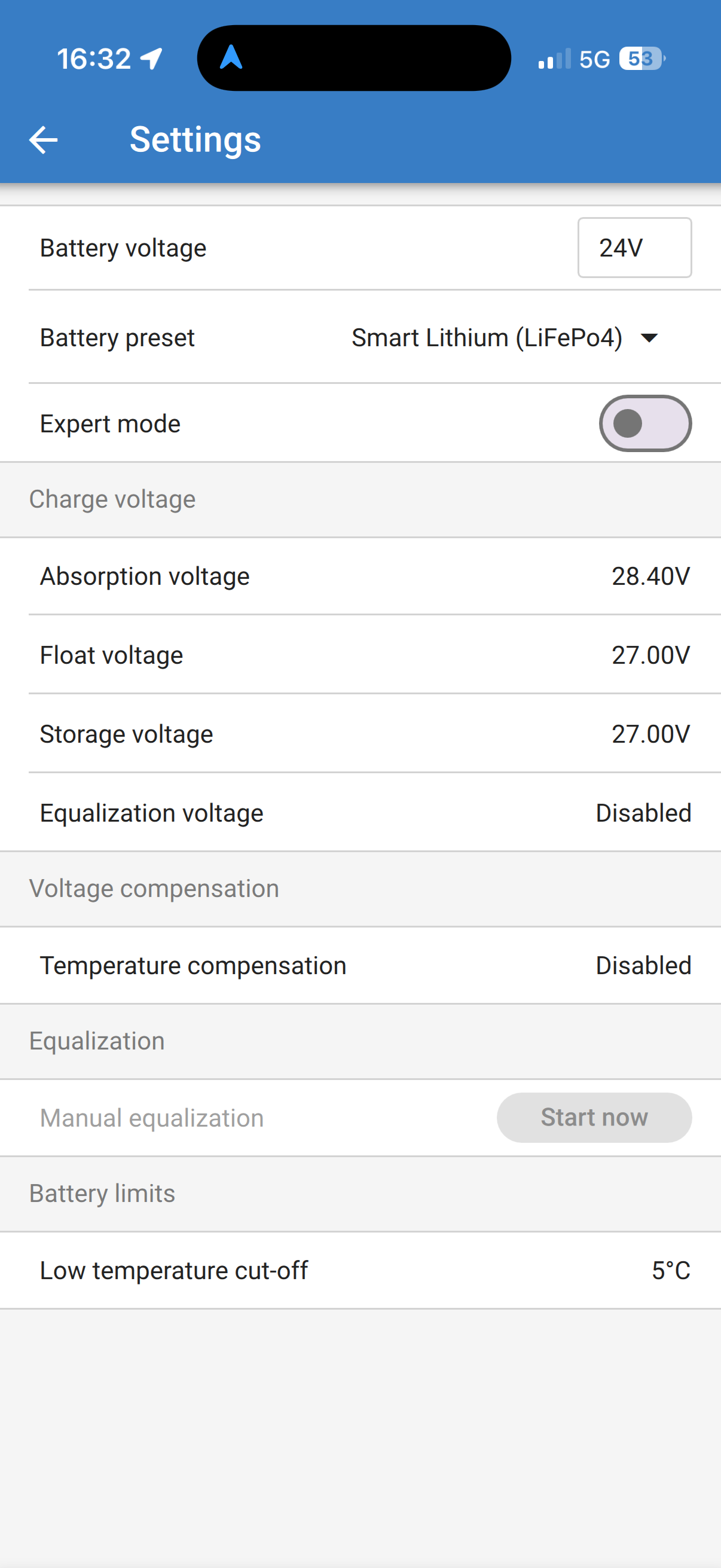

Input voltage too low… I tried every setting.
. I put the original orion in and it works! I have 12v alternator and 24v lifepo4 battery system.
What am I missing?
The input is set to 24V.
Thank you!!
I try it tomorrow. What I don’t understand is why does it not set it automatically , when i set the alternator to 12v and battery to 24v. :face_with_raised_eyebrow:
I wasted hours .
What voltage should i set it to?
IDK but I will report it as a bug to the VictronConnect team.
(But you didn’t check all settings :wink: )
You have to test that, look how the voltage of your alternator behaves under load.

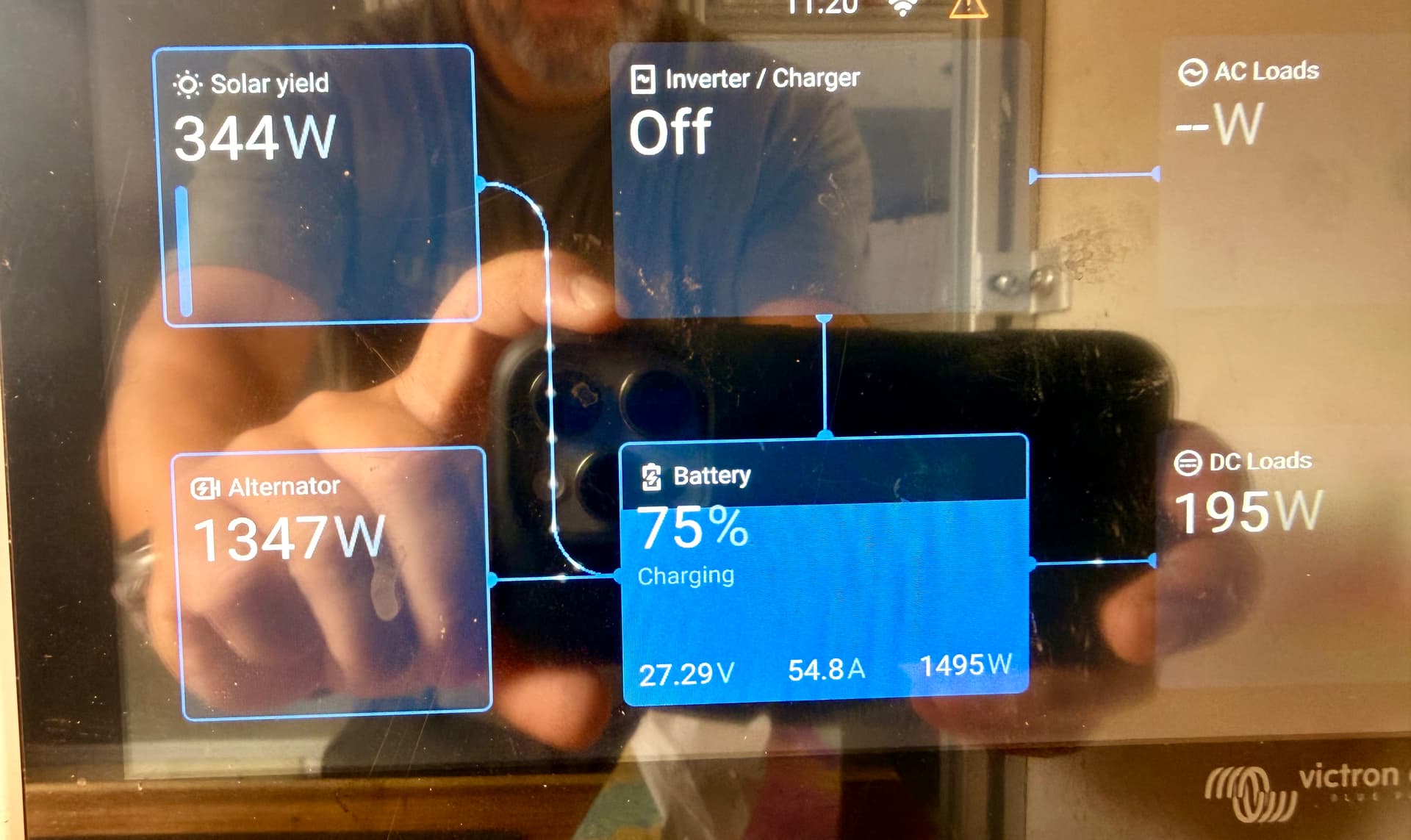

One more question:
I have 2x orion xs 1400
12 to 24v

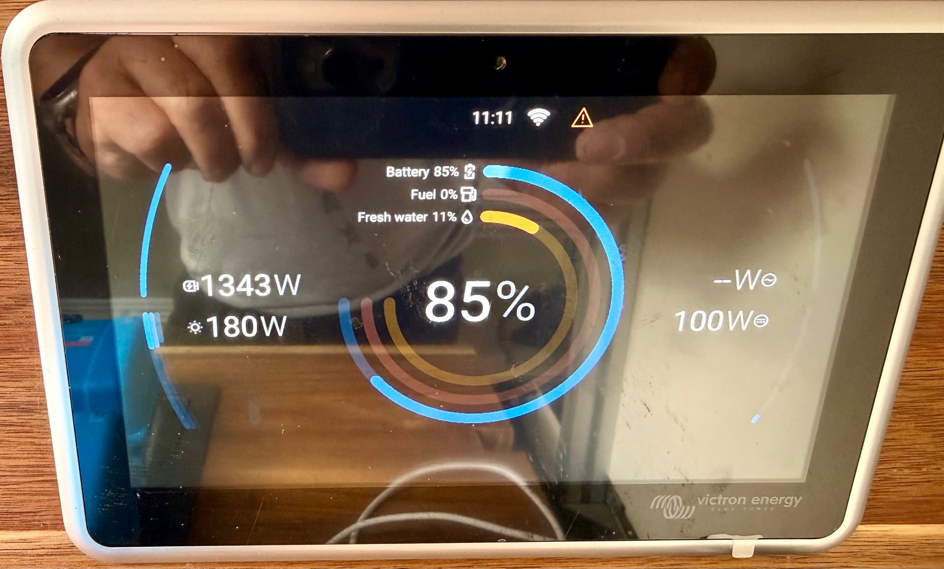

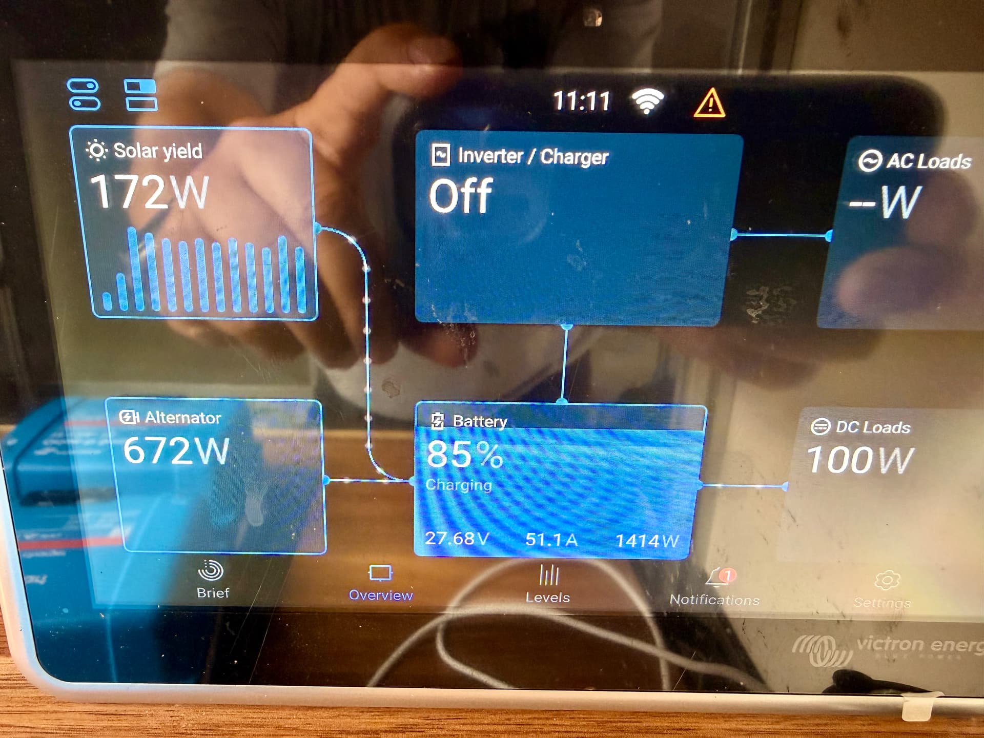

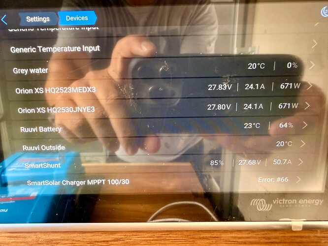

Alternator only shows half the charge on the “ overview “ screen. “ brief “ screen shows the full double output. Can it be combined?
The engine was just idling, it might produce the promised 2x 700w…when driving.
Thank you!
There was a software update on Ecrano gx today and it is showing both orion
xs as alternator :ok_hand:
