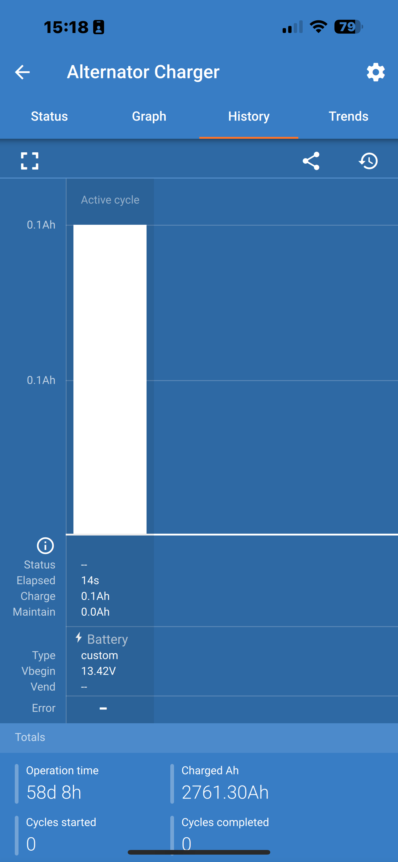

In the app for the Orion XS 12/12-50A, there is never any history shown. It also displays the operation time as 58d(screenshot attached).

Thank you. I now have a fully operational system. You were 100% correct. The supplying company had done the install diagram incorrectly. One other question, should the app show history data for the Dc-Dc like the solar one does?
@VWTransportert6.1 moved to the original.topic.
Glad that you got this sorte, as I said, not the first time we have seen this issue.
Stored Trends is a new feature that is not yet fully rolled out. The Orion XS is not listed in the VictronConnect app manual for this. i have not checked the Orion XS manual.
Thank you. Should the history tab work in the app or is that part of trends?
Not sure on that one.
