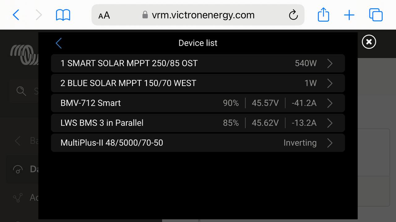

I do have the issue, as soon as I start connecting both MPPTS via VE.CAN to the cerbo, my older Bluesolar 150/70 charger stops charging, although the Charge status becomes equal to the newer SmartSolar 250/85. (jumping from bulk/ absorbtion/ float statusses is not the problem).
It seems like, as soon both mppts are connected to the cerbo, the older bluesolar seems to get a signal that it may not produce any power or something, as the power output drops to zero, even if it was producing 500-1000Watt before I connected it. Meaning in stand alone function is works proper, but this way I can not monitor remotely both mppt´s at the same time.

Just to share: I had a closer look on the connection status seen on the remote console and that looks as following.
  1. The system recognizes both MPPT connections via VE.CAN (daisy chain connected at the time of writing)
  2. the charge statuses are synced (seen by the display of the old MPPT and easy to observe by the leds of the newer MPPT)
  3. BUT, reading the statusses seen by the CERBO, there seems not to be a ´real´ master- slave situation, as the newer MPPT says ´stand-alone´ and the older MPPT says nothing about any connection status…
  4. → For me the conclusion as well, that they are not fully communicating with each other, just half, which seems not to work as I expected it would.
