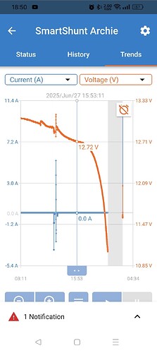

I have a brand new life po4 battery connected to my 75/15 charge controller and smart shunt. The battery instructions say store at 50% soc which i did. Today i thought i would check the system and the app did not pick up the shunt or controller.
I checked and no lights on either. Connected the battery to a victron charger an it came on. Seems like the battery voltage dropped to 11.06 in about 3 weeks from about 12.5 v when it showed 51%soc.
Any ideas as to why this would happen?
Nothing is connected to the battery that could draw power
Thanks

Yhe SmartShunt does not use voltage to srt SOC. It starts at 100% with a full battery. It then counts the energy out and the energy back in. When it is disconnected, then reconnected it can remember the last SOC value. If in the meantime your disconnected battery has self discharged then the shunt knows nothing about this. When you restart the system you need to recharge your battery fully with the shunt connected so they become synchronised as full battery and 100%.
