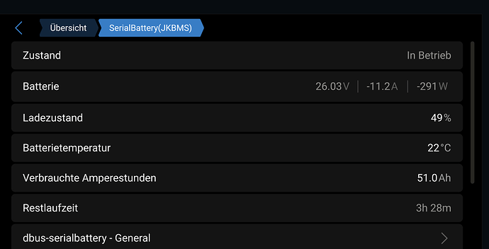

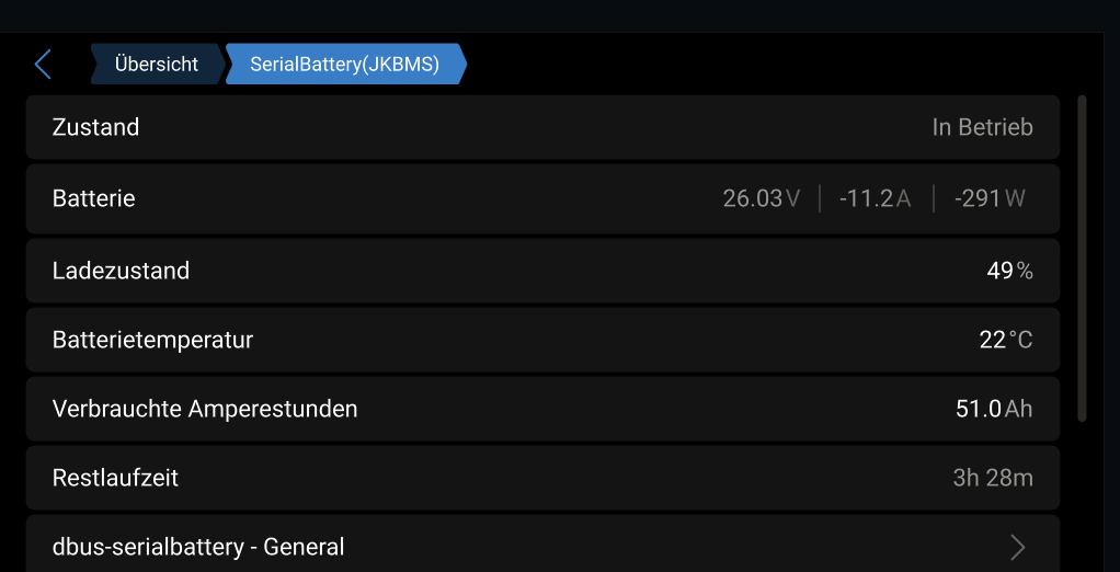

Like @M_Lange described, it’ss on your BMS page or SmartShunt ( I don’t have) information page.
Here a screenshot of my small 8S. in German it’s called “Restlaufzeit”.
Klick on the overview page button and then on the battery :wink:
BTW: if you’re using Gui V1 before, with 3.64 also V1 works fine.
You’ll find youre information at same place as before.
